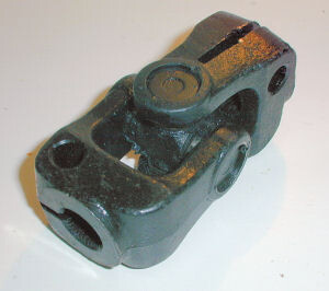

This is the one I converted my car to many years ago when the “rag joint” disintegrated. I believe it’s 36 splines. It might be available from other British car suppliers.

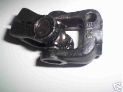

Thanks to all for responding. I bought a joint on ebay that is of the type suggested. I tried fitting it yesterday and found it had play in the joints and the supplied bolts were undersize allowing it to wobble on the shaft! I should have been warned by the sellers “No Returns”…
I had seen a joint, recommended by someone on this forum years ago, that looked very well made and was available from somewhere in Europe but cannot find the mention in the ‘search’ function. I will try ordering one from RD or DB and throw this one in the garbage!
David, if the seller will not accept a return, I would contact eBay for a refund because it was not functional and is a safety issue.

I thought I should give an update: I too found that the bolts would not tighten the joint and that was the problem all along-the joint was wobbling on the shaft despite the bolts being Very tight. I put the joint in a large vice and pinched it closed with a washer in the gap to prevent it totally closing. With good bolts, tightened very firmly, the joint now works fine!
