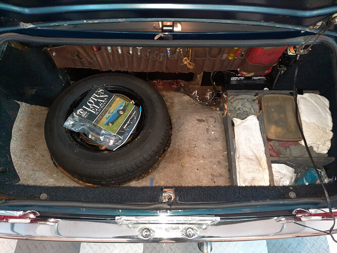

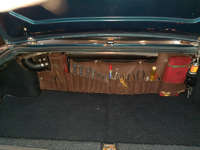

On the theory that “if I have it I won’t need it” I probably am a little over the top. Under the deck is spare ignition, plugs, cable ties, gorilla tape, safety wire, jack, repair manual, light bulbs, relays, ,
I do like your tool bag running across the tank board. Looks good! Did you make it yourself?
