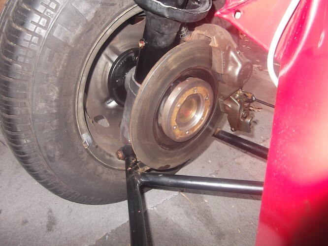

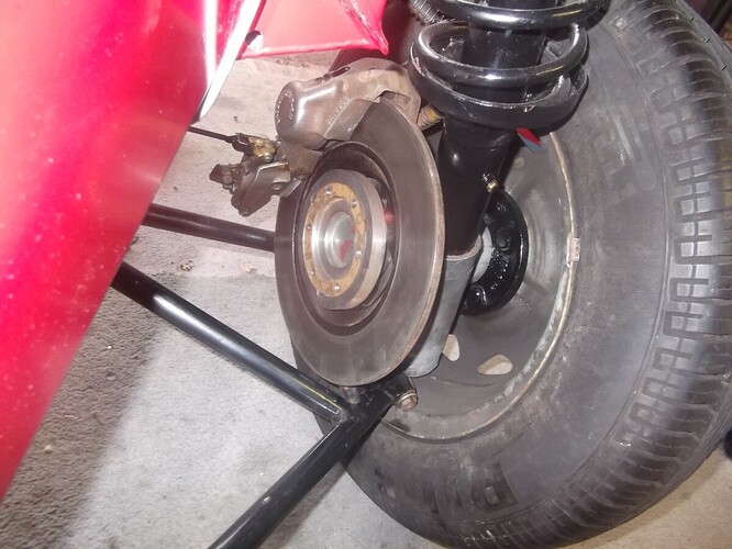

This doesn’t seem right. The rotor clears the wishbone arm by about 3mm. About the same on both sides.
Tom
Tom
[quote=“TomMull”]
[attachment=0]wishbone.jpg[/attachment]
“A miss is as good as a mile”- Colin Chapman
Okay, maybe he didn’t say that, but he certainly built cars that way.
That was also my immediate thought ! ![]()
OK then, thanks to both, scratch one off my lengthy worry list. Tom
yes it’s all quite tight in that area. outer wishbone bolts have to have pretty minimal heads to clear the wheel rim. position of tyre weights needs to be checked. A good idea to check the run-out of the various components, particularly if you pull the driveshafts.
I thought exactly the same when I first got under mine Tom - they all do that!
