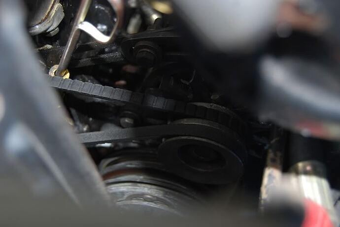

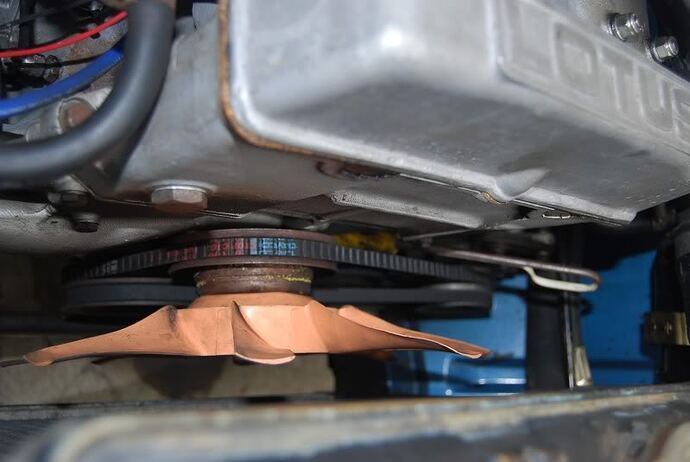

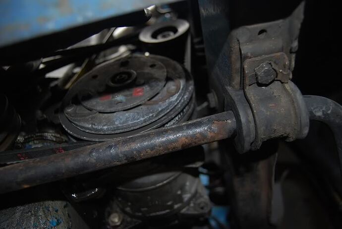

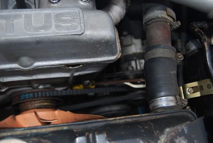

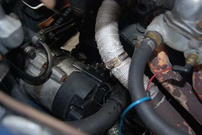

Hard to get a photo, probably easier to see if it was on a ramp and took some shots from underneath…but the way I did it required a double groove pulley on crank (from the aforementioned Escort 1600) and also on the alternator (available on ebay). No weekend job, it took me a few months to source and adapt all the bits and then about three-four attempts by the air-con people to commission it so it wouln’t leak. But now works well. Pretty sure the +2 has more lateral room down there (ie no chassis rail). Also (not in pics) has electric fan on the condenser and an idle step-up solenoid for when it’s running.
