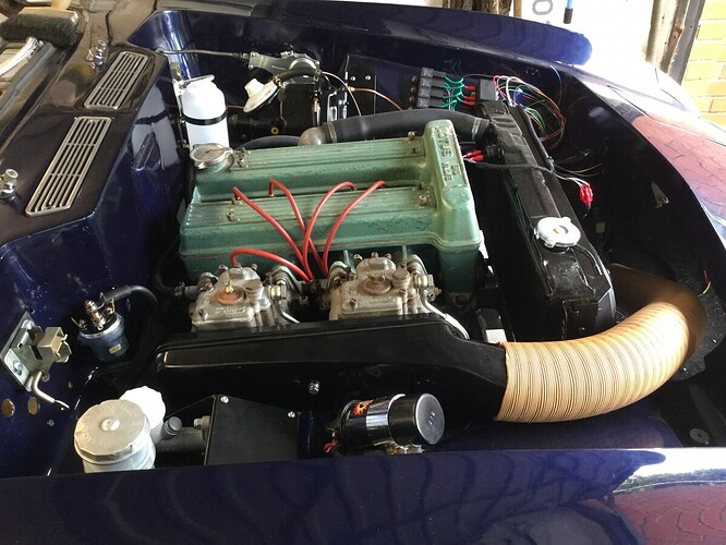

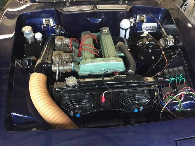

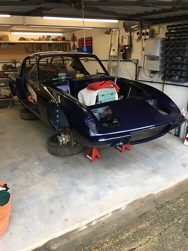

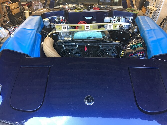

Thanks for the welcome and good wishes. A few photos attached, showing the car in March just as I got started on it and a few pictures of the engine bay as it is now with the carbs and pedal box trial assembled before I remove them again, overhaul the carbs, set the timing, install the air filter housing and complete the fuel lines and wiring.

Love that blue!
Great colour and immaculate engine bay. Good luck with the remaining rebuild. Regards, William

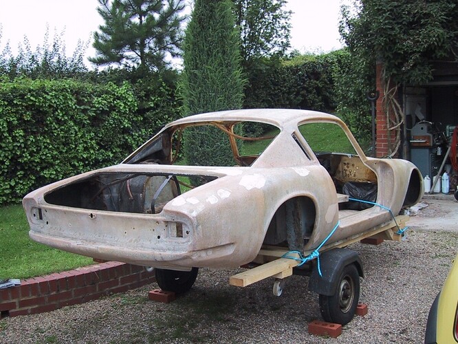

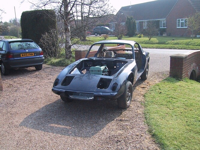

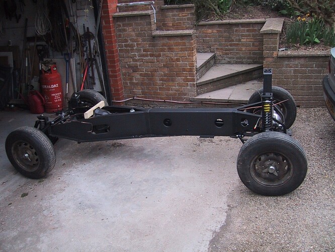

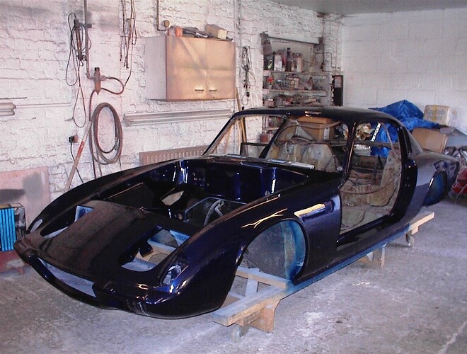

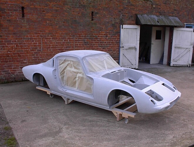

Thought I’d add a few pictures of the car as it was earlier in the restoration process.
The body was stripped to bare fibre glass and a temporary transport frame made for while it was away for respraying. The respray was done by a small local company and I’m very pleased with the results.

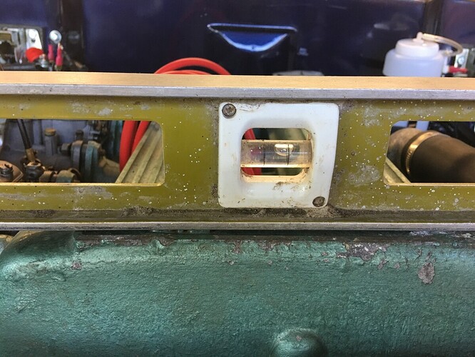

Is that an optical illusion or is the engine tilted?
John :wink:
Just been and checked, it is level, its just the angle the picture was taken at.
Phew!!
Simon

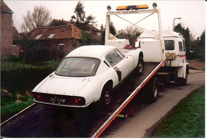

One more picture of the first time it went off to be renovated, this was last century and it came back unfinished about a year later when the garage doing the work closed down. This was when I think parts such as the servo and brake pedal box etc. went missing. :frowning:
Behind schedule! Snook off to the Isle of Man to watch the TT for a week, so need to put in more hours to catch up! Waiting for parts to arrive so plan to strip and overhaul both carbs as I have the kits for this and then fit the new clutch slave cylinder. Also noticed offside front wheel is tight to turn, so need to remove and check out the bearings before I fit the calliper and pads.
i think u have a point there john! Engine mounting on RHS is possibly at fault
looks to me like there might be very little clearance between the inner wing and the airbox?
I had the same problem after my rebuild and replaced the engine mounting with a beefed up one which solved the problem … and made it sooo much easier to access the weber bolts etc :wink:
Great story and your restoration is looking good! Keep the faith, your close to being back on the road. I know the feeling of driving a car you have personally restored, it is extremely satisfying and will add a new dimension to every drive.

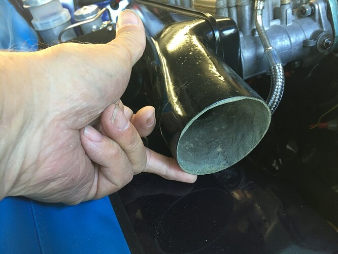

I’d like to compliment John Clegg on his eyesight. I’ve double checked and the engine is indeed not level. This became more obvious once I had the carbs and airbox finally fitted and found minimal clearance between the airbox outlet and the inner wing. The car is level on axle stands so the attached pictures of the spirit level show how far it is out. New engine mounts on order, might as well do both as they are the same age. Question though, what clearance have people typically got between a standard airbox and the inner wing.
