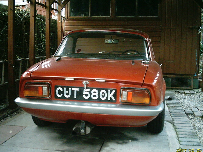

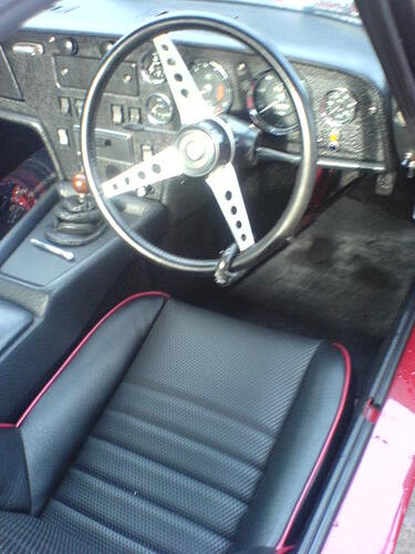

Some pictures you might find interesting- only one owner before me, bought in 1978 and nothing but trouble for the first 2 years. Much altered- 5 speed T9 box (pictured), no servo, plus 2 brakes, plus 2 rad, reworked panels, electric headlight lifts, oil cooler, contactless ignition, “slightly” altered interior with about 8 multiplugs behind the dash (comes out in around an hour), fully soundproofed, switched to alternator plus 8 way fuse box, all interior trim panels custom made, 5 inch minilites, stainless caliper pistons, custom stainless fuel tank, door deadlocks, almost full rewire, no relays under the bonnet-now inside the car out of water spray. Still has original engine and head which has never been skimmed, engine left in std tune, diff is 3.5 RS2000 fitted about 28 years ago. Not a purists car I know but very usable, doesn’t leak into the cabin or overheat etc- I wanted something approaching a “turn the key and forget” car like the very first one I had- a bog std S4 which I foolishly sold being young and knowing everything!. This one was a nightmare compared to that one with just about something going seriously wrong virtually every month for the first 2 years of owning it.
Still to do-hmmmmmm- I’m about to fit a MCT75 box since 3rd on the existing one is becoming slightly problematic in terms of noise (probably bearings), needs what is probably attention to the cam that drives the dizzy (slightly clattery) plus some minor attention to the paint- might be finished then (laugh inwardly).
Car looks great in the pictures but it’s better in the flesh
Really looks nice, but a little word to the wise from bitter experience. That crook lock you have on, take it off, I had one on my first Sprint they just bent the steering wheel to get it off it was very easy for them. Put some sort of switch in the ignition circuit or on an electric petrol pump. I was very upset when they bent my Chapman wheel, they could not start it because I had the rotor arm in my pocket.

Thanks for the comments. Slim Romeo- good luck today with the MoT- did you check the fit of the steering wheel?

Re security- good point about “wheel bending” by lowlifes. I won’t reveal just why it couldn’t be done on this car but your point is certainly valid. All I’ll say is that the brake pedal doesn’t depress if I don’t want it too!

That is only the third Carmine Red (if that’s what it is) I have ever seen. Looks like all three of them may be within 50 miles of each other too!
