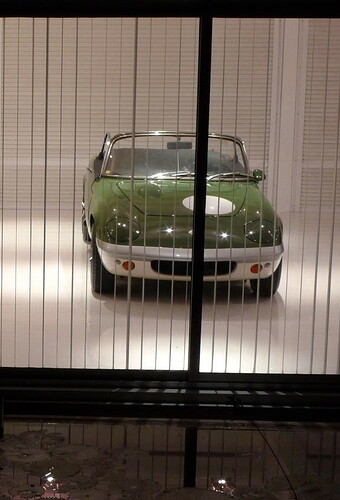

Just a short note to see if I can upload a photo of my Elan, which I haven’t started in a while.
Andy

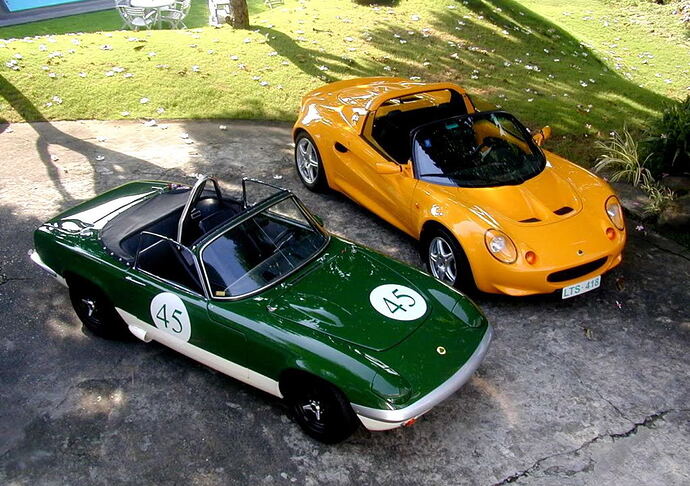

Here is the Elan with a then new Elise in a photo taken over a decade ago.
The Elan was in “softer” race mode here, with a hoop replacing the full Tony Thompson Racing roll bar. However, the aluminum bulkhead separating the cockpit from the boot (and the fuel tank) was still in place, along with the racing harness. The local sports car club, which oversees historic racing, agreed to let me have “45” as my racing number, appropriate of course for a Series 4 Elan.

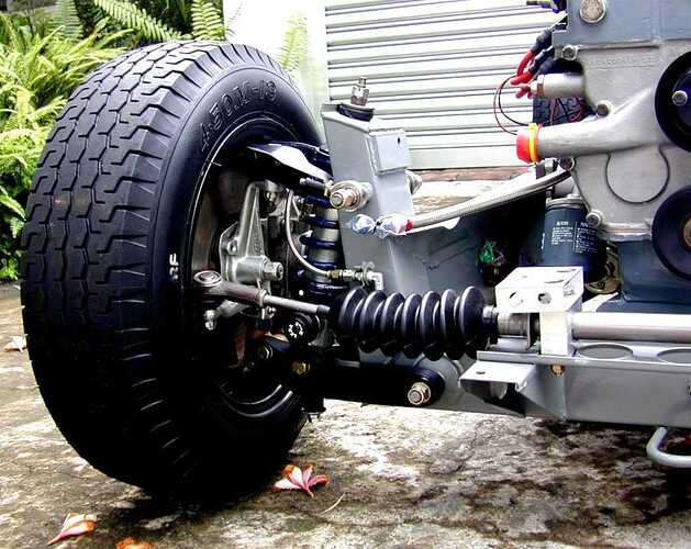

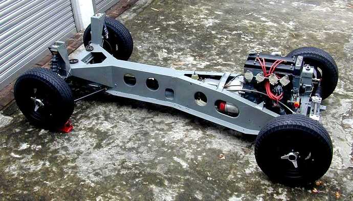

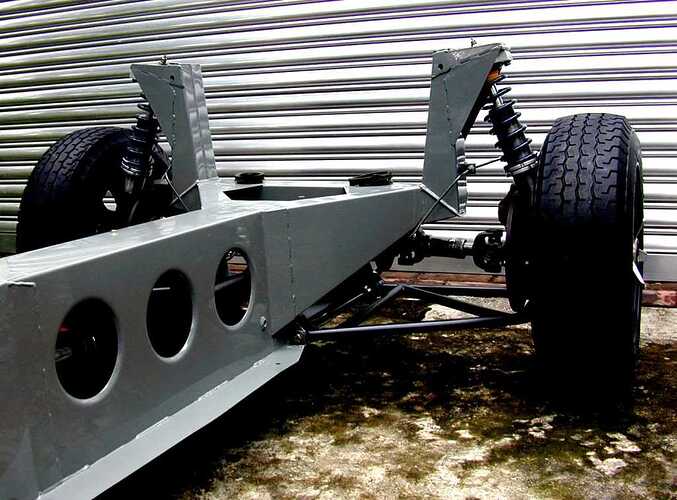

During the 1st restoration of my Elan in 1980-82, I added gussets and stiffening tabs to the frame as was suggested in Lotus ReMarque, the newsletter of the U.S. club Lotus Ltd. That worked very well. In 1996, I restored the car again and repainted the frame, professionally this time, in light gray; I sprayed it myself in 1980 in a very, very dark gray.
However, at a race in 1998, I spun and bent the front left corner of the frame. I wrote about this incident in this forum then and received much encouragement to rebuild. I picked up quickly and restored the car a 3rd time. I had the frame straightened on a computerized jig, which probably resulted in a frame of closer tolerances than the original. However, to ease the pain of the unscheduled restoration, I took the opportunity to “upgrade” and install a 26R-style frame from Tony Thompson Racing. The chassis looked to me as if it were on steroids.
In rebuilding the suspension of my Elan in the late 1990s, I veered more strongly toward racing. I previously replaced the metalastic bushings with nylon equivalents, but, in this restoration, replaced the standard suspension arms with lowered versions, using rod ends. I had stiffer, shorter springs on dampers supplied by Lee Chapman. Most everything else came from Tony Thompson, who was extremely helpful and supportive, considering I was several thousands of miles away. The steering arm had to be bent a bit, so I retained the original ones and had Tony Thompson provide arms bent to suit.
Not too evident in the picture is the large aluminum brake caliper, as installed I think on the 26R. The large stainless-steel braided hose is the fuel line from the electric pump I would install in the boot.
When I retired the car from competition, I replaced the dampers and springs, dialed up the ride height, and, on advice of many on this forum, retained the rod ends.

Now, the rear suspension. The Rotoflex joints were replaced with U-joints, which at the time were (and may still be) the only permitted vintage-racing modification. The strut housing is magnesium; I fitted Konis and small-diameter springs. Heim or rose joints replaced metalastic bushings. Note the beefy, gusseted chassis arms.

In 1977, I ordered an engine from Vegantune to replace the Stromberg-carbureted engine that came with the Lotus. In 1998, I replaced the Vegantune with a steel engine from QED, using an original “L” block (a block with “L” embossed near the RG engine mount). Here is the QED engine as it now sits No. 8439. It is a very “high-spec” engine.
The cockpit is still in “racing” node, with a 26R-style radiator and swirl pot, a fuel-pressure regulator, and Aeroquip hoses, but it is otherwise original. I have not used the QED on the street since the car was retired from vintage racing, but hope to do so early next year.

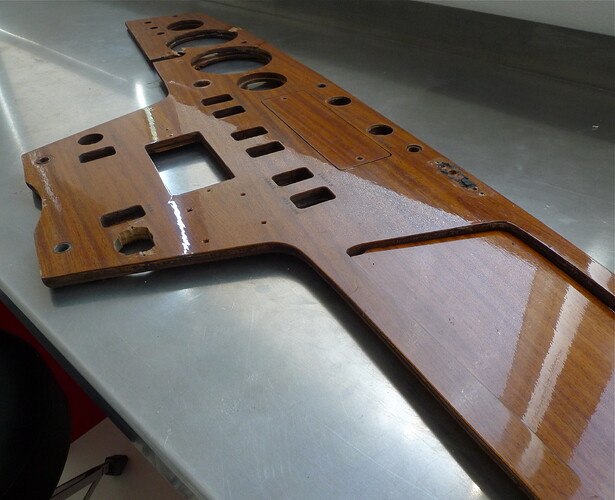

During yesterday’s once-every-8-years storage clean-up, I found this wood dashboard for my 1969 Lotus Elan. A friend who managed a shop that made doors cut the blank for me and sprayed it with a thick plastic-like coat. At home, I sanded that coat down with an orbital sander, then by hand with very fine sandpaper until it was glass-smooth. Then, I installed the labels, using Letraset by hand, a letter at a time. That was in 1978 or so, 31 years ago.
In 1998, I had an “off” at a vintage race at Subic. The accident stressed the steering column and body, cracking the the dashboard. In the rebuild that followed, I replaced the dashboard with a beautiful one made by a craftsman in the U.S. But I kept my handmade dashboard. I marvel now how young eyes and hands were able to place each letter down so precisely and wonder whether it is now time to let it go.
Hi Andy,
Not that you were asking - My 2 cents -
Unless you have no space to keep it…Don’t let it go. I’m not pack rat but pieces like these ( for me anyway) provide spontaneous trips down memory lane - Bent control arms, broken gears, old dash boards. body panels. steering wheels. ancient pieces of magnesium etc i like to keep them if they are tied to an experience.
george
Thanks, George. It’s hard to let it go. It’s been with me more than half my lifetime. My best, Andy
