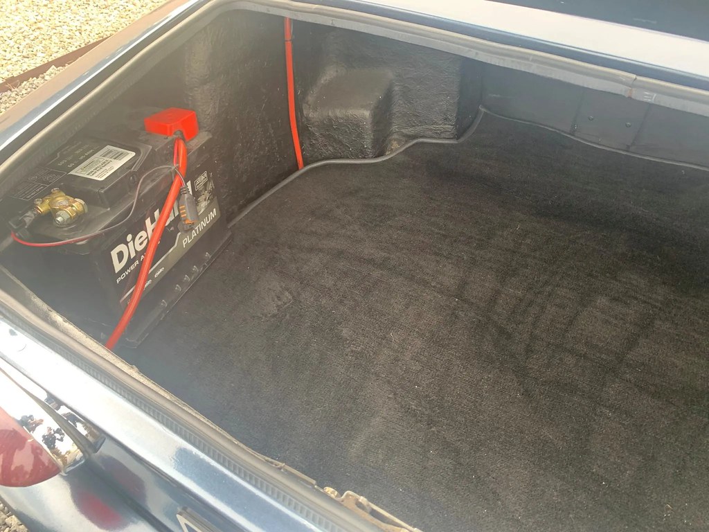

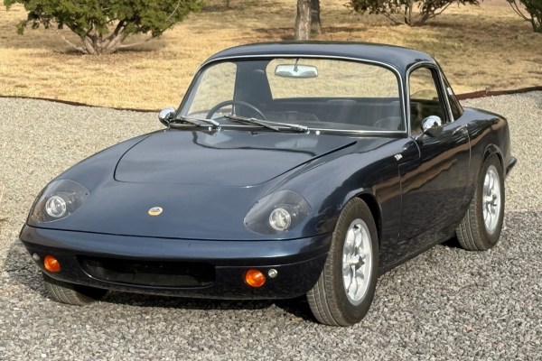

-Number One project I noticed in the picture was the battery didn’t appear to be fully secured. I will get a closer look, but it appears to be secured from fore-aft movement, but not side to side. I plan to take this car into the canyons, so this needs to be secure.
-Number Two project is related to the Minilites. I LOVE Minilites and was going to get these for my own project, so these aren’t going anywhere. In fact, I’m selling the two spare OEM Wheels so I can have a Minilite spare. However, the Minilites were listed as rubbing on cornering which is something that Tony Thompson also mentions (IN BOLD nonetheless) so this is another issue I will need to address before taking this to the canyons.
-Number Three project is to do something about the headlights. I know many aren’t a fan of this look. I LOVE the 26R look, and I love having good headlights so I have a plan to improve this look. I think its one of the things that likely held people back on bidding.
-The Final, initial project will be to add brightness (see what I did there?). The Elan is tiny. We all know this, but the general public has no idea and ideally I want them to know I am there on the road with them. Normally for the Elan, I would want a bright color, but as I don’t want to deal with a color change on the car YET I need to find some simple solutions to make the car more visible. Having good headlights is one item and one reason why I want to keep the Hellas. As for the car itself, I was thinking that removing and re-wrapping the ‘bumpers’ with a chrome vinyl wrap would be a good start. I know that the Elan normally has Silver bumpers, but I don’t think that will attract attention like chrome will. Open to the communities suggestions here.

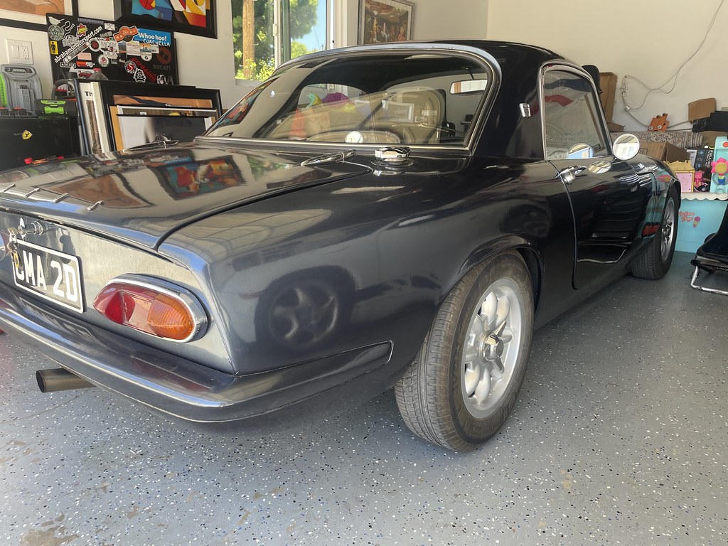

Great door fit. Is the other side just as good?
You tell me! haha
I moved the seat from the rear position to the front position so now I can sit in the car without needing a pillow behind me. Much easier than expected, which is great news for when I want to try out the 26R seat.

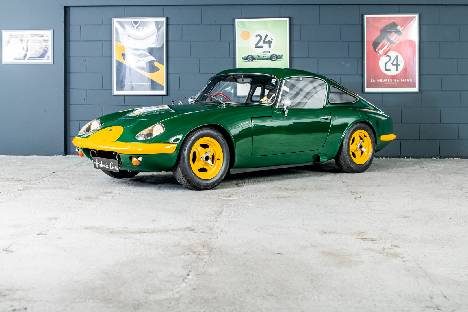

Speedholics had a 26R in green with yellow accents, please see:
The yellow for sure attends more attention than when green only, although the form is not mine cup of tea, but it´s just for the idea. :wink:

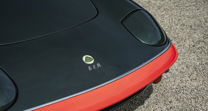

But to accentuate the bumpers alone is also something nice, like the BRM colours:
Again congrats with your Elan, very nice! :ok_hand:

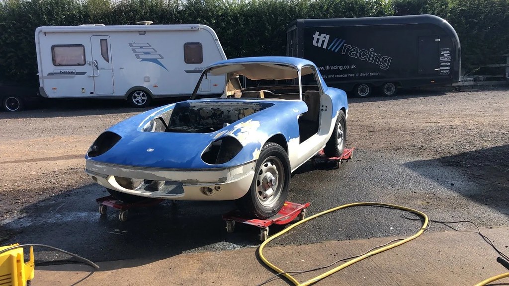

Heres a pic from the auction that showed the prep work done prior to the wrap. It looked more ‘complete’ just prior to this as you generally want a good smooth surface for the wrap to adhere to
I think ultimately it will get a re-wrap in Red -Golf Leaf Livery, but thats a problem for another day. The Red/Orange bumpers is an odd combo for me, so still leaning towards a chrome-vinyl for the bumpers since it will appear era-correct in some fashion as the cars from the 60s had chrome bumpers. I think it will compliment the chrome on the rest of the car, so hopefully the mental image will look good in real life… anyways,

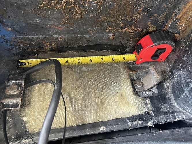

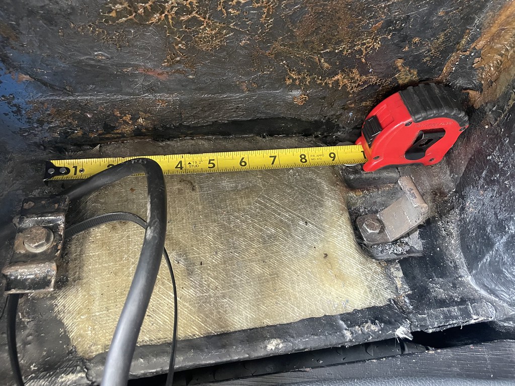

Project (1) - Battery
Reusing the pic from the auction, but this is how it looks sitting in place.

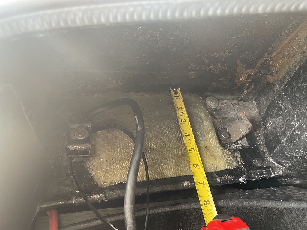

Removing the battery and assessing the space, so I can compare the width & depth I had to use. It appears there has been some fresh fiberglass in place, either as a reinforcement or repair. Still looks good and isnt a concern for me. (How about you?)
​The Plan
As an avid ‘dumpster diver’ I had already scoured the classifieds on Lotus Talk and found a homemade battery bracket that was designed for use in an Elise and using a DEKA ETX20L Battery. Might save a few pounds in this process, but the aim was more to have it secure for my canyon runs. Bracket is en-route where I will confirm if it was worth the 2- Jacksons I spent on it.
I will buy the battery once that’s all confirmed and see if I can check this off and move on to Project (2)

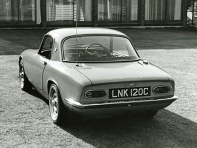

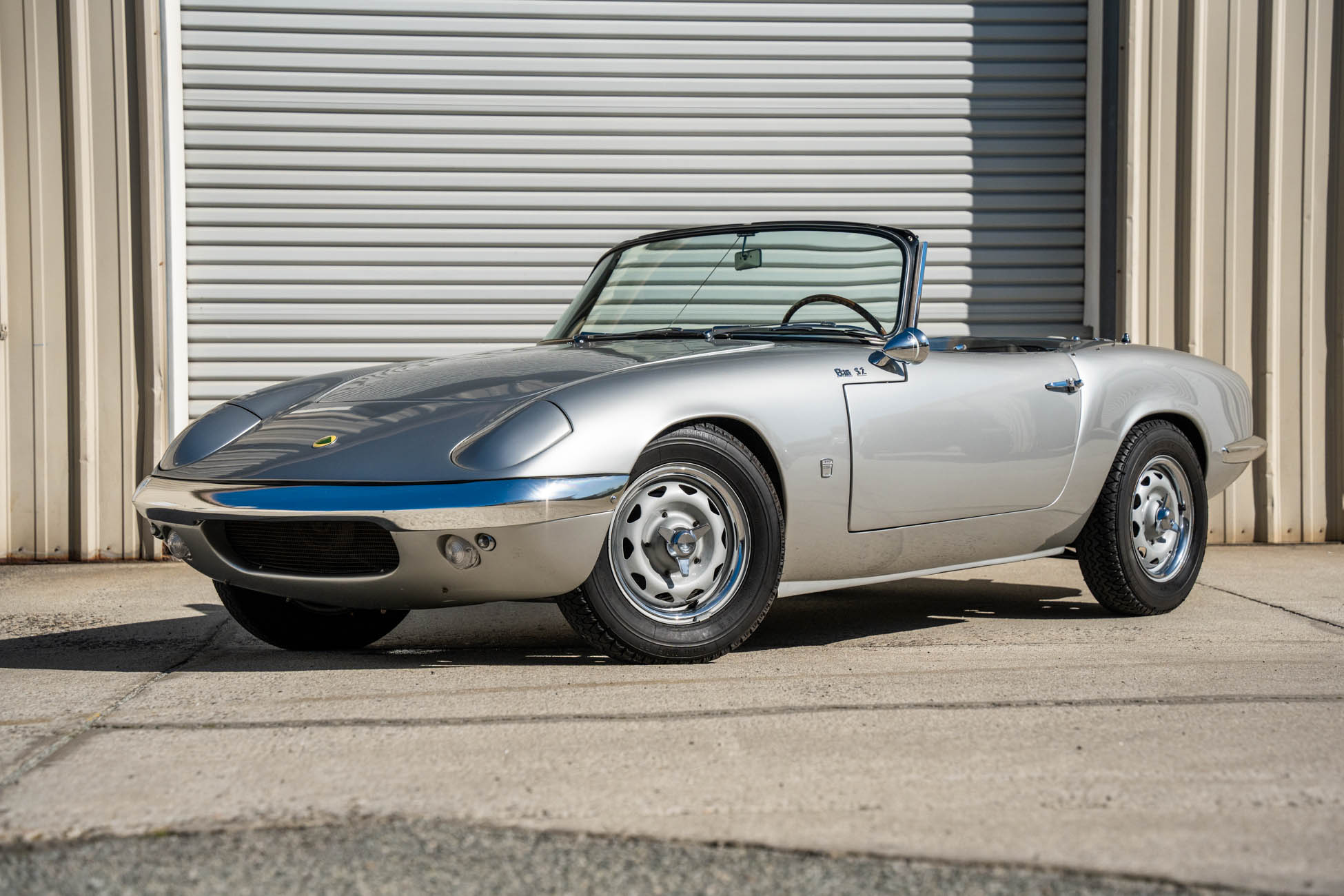

Only one set of chrome bumpers were ever fitted to an Elan by the factory. I believe two sets were made up. One set were binned since the chrome just would not adhere uniformly to the fibreglass. The other set were used at various times on the LNK 120C and HAR 493C press cars and thence on Graham Arnold’s own Elan. They are not thought to have survived.
With the advent of decent wrap it should be possible to recreate the chrome bumpers.
There was an Elan with chrome bumpers on Bring a Trailer a couple of months ago. @2mAn,if you missed that previously, check it out. There are a number of color photos that show the effect. https://bringatrailer.com/listing/1966-lotus-elan-s2-11/
