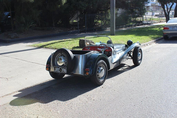

As I posted a few weeks ago, I’ve brought home a stablemate for my Elan, a 65 Lotus Seven S2. My “new” Seven spent most of its life in Melbourne suburbs of Victoria, having been imported by the original owner when he emigrated from London back to Australia in 1966. Its first 35+ years saw two owners, a couple paint jobs (1 well done to full-body BRG, the second a very sloppy red over the green), and about 45k miles. It was apparently primarily a road car, though it was run in at least a couple club events and hillclimbs (with a broken piston to show for one of them). Since then, it has had 3 or 4 owners (still working to fill in the gaps) and been driven very lightly (less than 5k miles if the odometer is to be believed, and what I’ve learned so far leads me to believe it). The poor paint job was scraped off in the early 2010s and the car stayed aluminum and and green until it was exported to the UK in 2017, where the latest owner returned it to aluminum and red, as it left Cheshunt in 1965. To my knowledge, the bonnet, nose and one front wing are the only body parts that have been replaced.

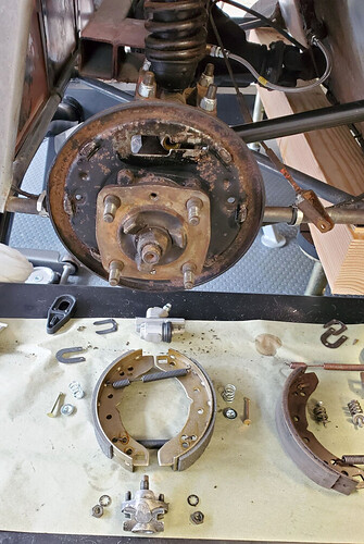

I’ve started on the rear, rebuilding the brakes (shoes, cylinders, springs, flexible line) and replacing the rubber bushings in the a-arm and trailing arms. I’ve also replaced the brake and clutch master cylinders. Next up will be the clutch slave cylinder and hydraulic line, front suspension bushings, trunnions, and inspection/testing the front brakes.

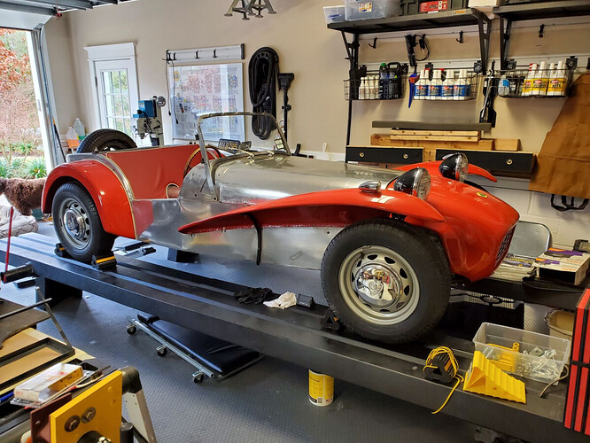

My plans are to keep it as-is, I really like the aluminum and red combination. Though some areas of the aluminum show their age and a thorough paint job might hide the flaws, I like the patina and aging it has that show it has been used not just stored. As good a shape as it is generally in, I can’t see doing a complete restoration to factory condition, I think this one is going to be best restored mechanically where and when necessary but otherwise used and maintained as the 55 year old fun car it was intended to be.

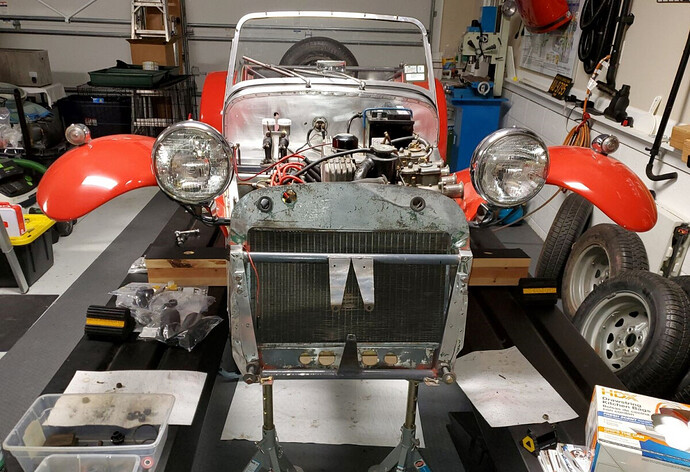

With rear brakes back together, I started dismantling the front suspension and steering.
It is in surprisingly good shape for a 55 year old car. Wishbones and ARB in excellent shape, really don’t even need much cleaning and probably won’t waste time putting paint on them right now. I’ll clean and repaint the vertical links, caliper brackets, steering arms, and dust shields, but they are all solid. Vertical link threads show almost no wear at all!
The front brake calipers were visually ok but pistons seized. Not knowing the history, I’m taking the safe road and having them fully reconditioned and rebuilt (or more accurately exchanging them for a set already reconditioned). I debated doing it myself, but reconditioned type 12s are fairly inexpensive and it is worth it for piece of mind.

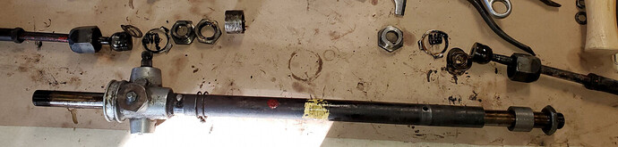

Steering unit likewise looked pretty good on initial disassembly, just tired grease and muck of age but nothing a good cleaning and fresh grease won’t handle. I suspect I’ll find the same when I pull out the pinion assembly and rack.
The car does look a little funny, though, with no front end!
