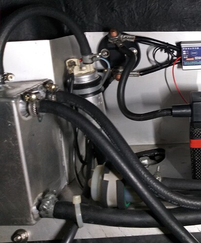

I know that many owners with Weber’s use this pump: Fuel Pump Pierburg :: Custom & Speed Parts (CSP)_gaNjMwODE4ODk2LjE3NDExNjYyMjk._ga_BL4HKS9RVEMTc0MTE2NjIyOC4xLjAuMTc0MTE2NjIyOC4wLjAuMA…
You don’t need a pressure regulator for this pump, and it’s also quiet. Always use a good filter on the intake side. Suction height is not a problem.
In my Elan since 1993 without any problems One in a Mitsubishi with a carburetor in the 90s, ran more than 200k km until I sold the car. I can only recommend it.
