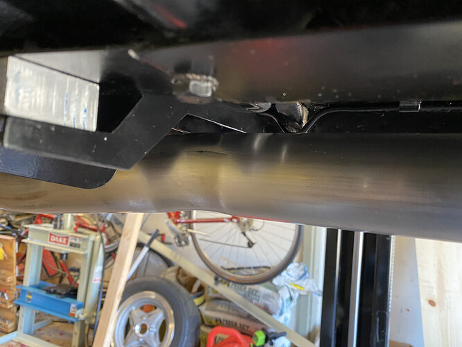

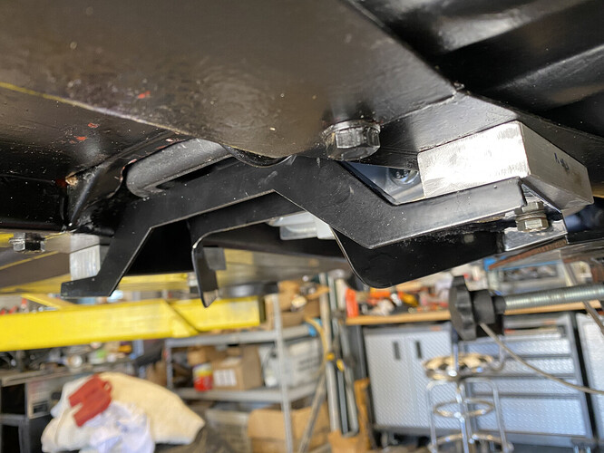

Steve, I’ll remind you that I had this same problem, especially with the TTR large bore (race systems) exhaust. I got around the problem by using the standard transmission support (actually used an upgraded, stronger version from TTR). I rotated it 180 degrees and then dropped it 3/4” with some aluminum spacers. Just gave me enough room for the exhaust. Not sure it buys you 1/2 inch but it was just enough in my case such that there is no contact or rattling/vibration.
Uses existing threaded frame holes and transmission saddle. No frame drilling or fabrication needed except for the spacers constructed from aluminum bar stock. And just longer bolts through the spacers are needed. Positions the transmission in exactly the same place as the Voigt mounting plate but with a little more clearance for the exhaust.
