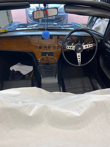

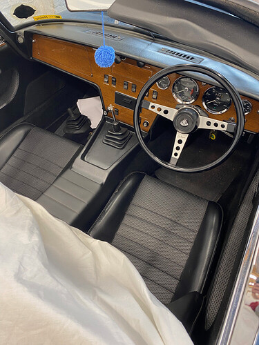

after a couple months getting work vehicles sorted, I’ve some time to drive a Lotus again.
new condenser, points, cap, rotor, plugs, wires etc
feeling much better, driving much better
all around, you guessed it. much better!

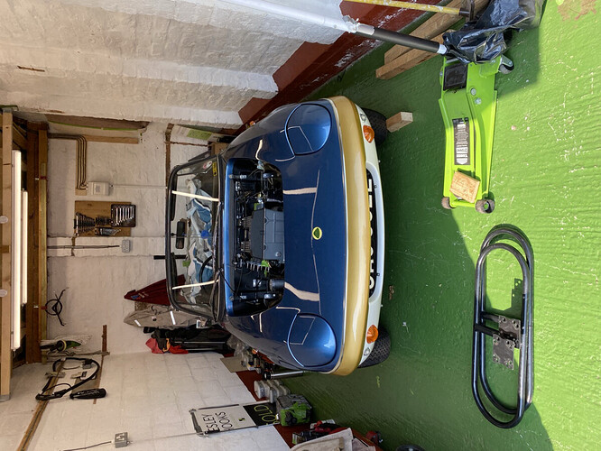

Refitted this bad boy today…
I have fitting the exhaust engine mount…:frowning:
Fluids in…
Gearlever in…
Failed original exhaust side engine mount replaced, now the engine cant is fine. I bought some of the Kelvedon £40 versions but didnt fit them… mounting holes on the passenger side one are out, even on the replacement one I asked for.
Just propshaft to connect and ready to go…
As a matter of note, none of the original trim or gearbox parts (even clutch slave cylinder) have been used in this conversion so the car be put back to original. A note on the Paul Matty repro console though, its about 3/8" shorter than the original.
Startup of the Smurthwaite engine tomorrow or Wednesday…

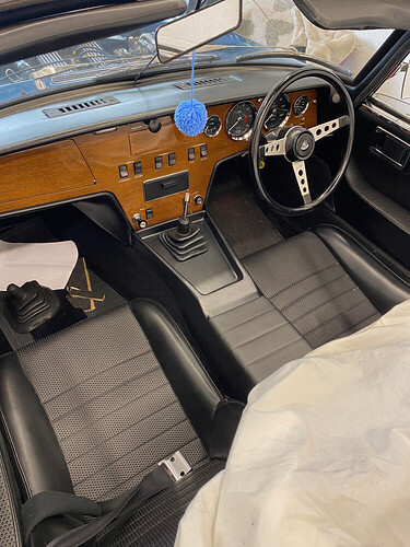

Just about finished up all the little projects for the car before taking off for the 1200 mi trip to LOG 40. Including:
  • Replaced the wiper gear boxes. I was losing blades and getting random blade parking. Now solved.
  • Epoxied in some metal plates, drilled and tapped to hold down the shift lever gaiter.
  • Removed all bullets in the interior harness, replaced with Mate-n-Lok connectors, making it easier to remove and install the dash.
  • Installed threaded inserts in the dash panel for the trim pieces and bonnet release.
  • I had previously put in footwell lights, but the drivers side weren’t attached, now they’re screwed into wood block epoxied to the underside of the dash top.
  • When I installed the 5-speed, I cut the radio antennae when trimming the carpet around the shift opening. Now the antennae is spliced.
  • The heater fan would whine for 20 seconds or so on starting up. I rebuilt the heater box, and disassembled and oiled the fan motor. Now it purrs…
  • I recentered the steering shaft turn-signal reset thingy, so now the signals cancel correctly.
  • After multiple attempts, I think I’ve finally adjusted the bonnet latches so the passenger one actually holds the bonnet down at speed.
  • The passenger door had sagged a little, requiring it to be lifted to latch. Adjusted so that it closes easily.
  • Adjusted the front suspension coil overs to give another fraction of road clearance.
  • Replaced the brake fluid, an every 2 year ritual.
Last thing on the list is to replace the tires. General Altimax RTs. They’re supposed to arrive tomorrow.

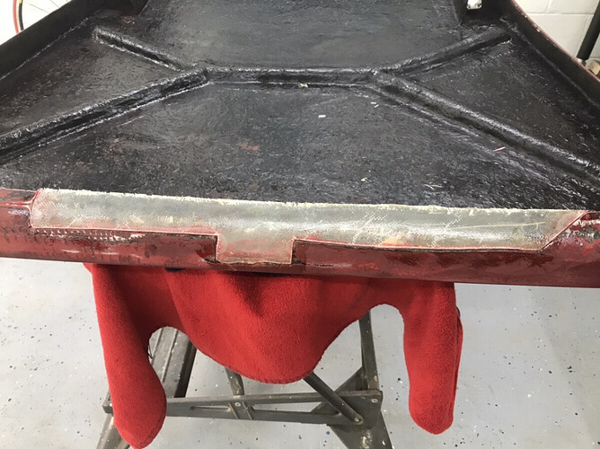

Removing the somewhat mysterious cutout. Or should I say fibreglassing in the cutout. Not finished yet obviously.
