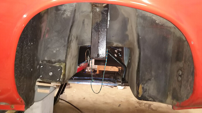

Completed the strip down, now on to refurbishing parts. So lots of cleaning and painting up coming.

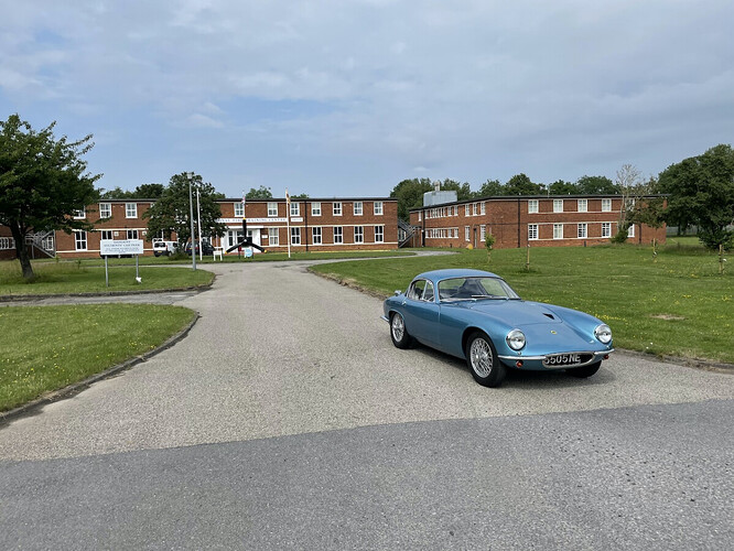

Took the Elite for a run out to visit a friend whom works at the local airport.

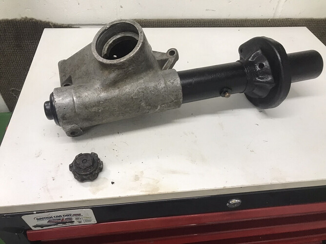

The small piece you see, the bottom remains of an early damper, was well corroded seized into the bottom of the tube rendering the unit unusable -(caused insufficient height for an insert). After copious amounts of liquid wrench, drilled a small hole in the bottom of the tube and managed to knock it out, then epoxy’d in a small shallow head screw to seal back up the hole,… so it is now a usable part.
Telling wife “I had this unusable part…” at which point mid sentence she interrupted: “we have moved and stored an unusable part?”…. hmm me thinking. “an?” if she only knew…. :laughing:
:laughing: indeed if she did!
and, nice save!

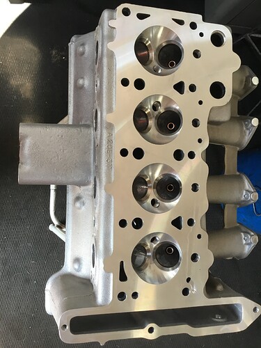

I opened my post and what did I find…? A QED head!! Yipeeee!
1 „Gefällt mir“
Nice and shiny too :smiley:
Happy me!
