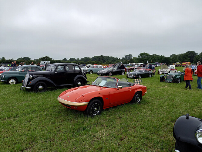

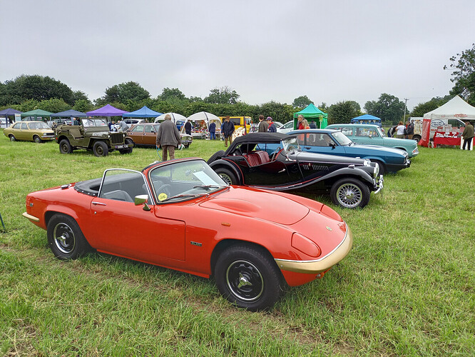

I attended the Watford Village Classic today, weather was poor but the forecast rain stayed away.

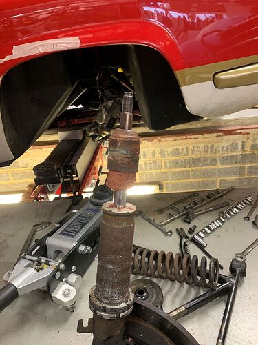

Long overdue suspension refresh.
Mission creep has set in and I’ll get the diff rebuilt with an LSD and Atlas outputs. Have decided to ditch the Spyder driveshafts. New rubber/poly all around. Adjustable rear lower arm. TTR shocks and springs

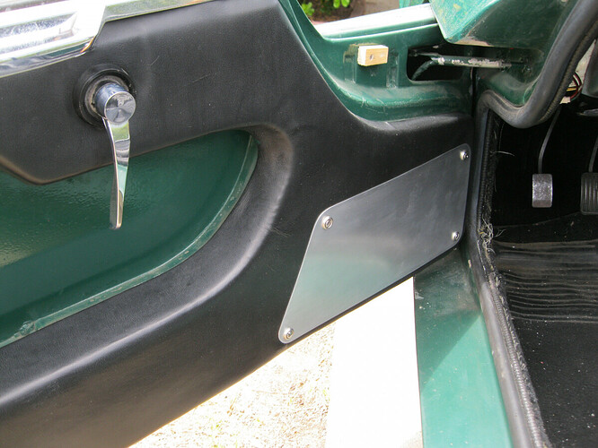

My car didn’t have them, so I installed new kick panels…because, you know, I always kick the door on the way out…

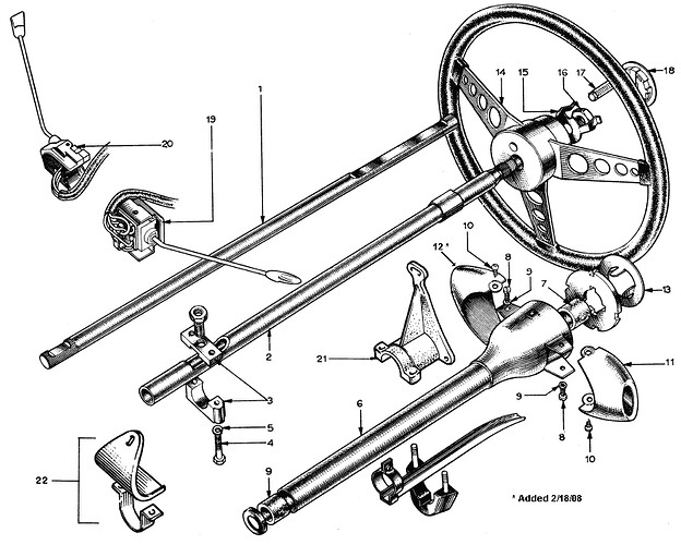

Took the speedo out to send it off for recalibration - a nightmare of a job - one result from fitting a 3:1 diff!! Any one got an easy way of getting speedos in and out? D
Fiddly, maybe, but ‘nightmare’? If it’s got the original style knurled retaining nuts and bracket you reach behind the dash and remove them by feel, then pull the speedometer out of the dash and disconnect the wiring and drive cable when it’s easy to see what you are doing.
On reassembly, tidy the wiring (ensuring a bit of slack) and the drive cable run to make it easier to do the above next time, at least.
Well yes - but it hits the steering column and indicator jobbies and all else besides. No clearance obvious. D
Steering column length is adjustable, so loosen its clamps (at 3 and 21 in diagram) and pull away from the dash.
I just removed the switches off the column and wiggled it a bit, but not easy.
Now how long will calibration take…
