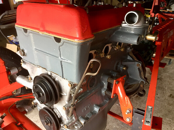

A beautiful job Phil, I know how many many hours go into getting the engine bay straight!
Do you mind me asking why you changed the head?

How did you end up with Webers? All Federal Sprints came with Strombergs, right?
Thanks for the nice comments guys.
No problem, my car came with the head discussed in this thread - https://lotuselan.net/forums/viewtopic.php?f=39&t=43120. It was an unknown entity re: valve sizes & cams, It’s a good head, but I managed to buy a relatively unused Sprint head from Europe a few years ago & it looks more UK/Euro stock. I wil probably overhaul the old head & sell it.

Yes my Car was built with Strombergs, but the head was changed over to a Weber one prior to 2008 when the car was restored by a previous owner.

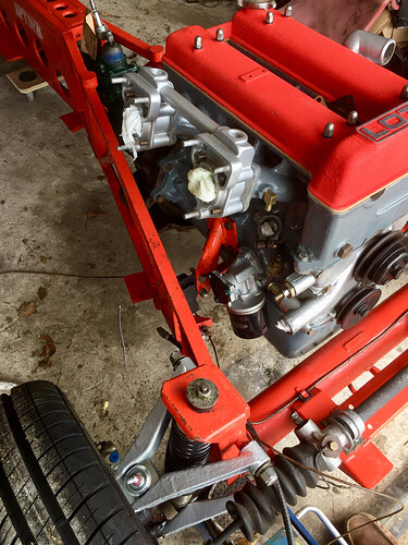

I chiselled out my old spigot bearing and replaced it with a fresh one from Sue Miller. I then fitted a Borg and Beck clutch kit with shiny new bolts and lock washers.
I test fitted my engine and gearbox into my Spyder chassis.

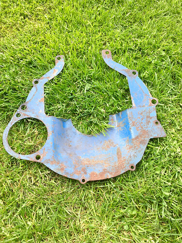

Problem was fitting the sandwich plate - I gave up and will have to do it all again. The chap who sold me it told me it came from and Elan’s TwinCam, but I couldn’t get it to sit happily with the rear engine cover. Mine is a lip seal, 6 bolt crank engine - perhaps this is for a rope seal model? Any tips? I thought I could cut away the blue plate where the upper edge of the bulge hits the bottom of the rear cover?

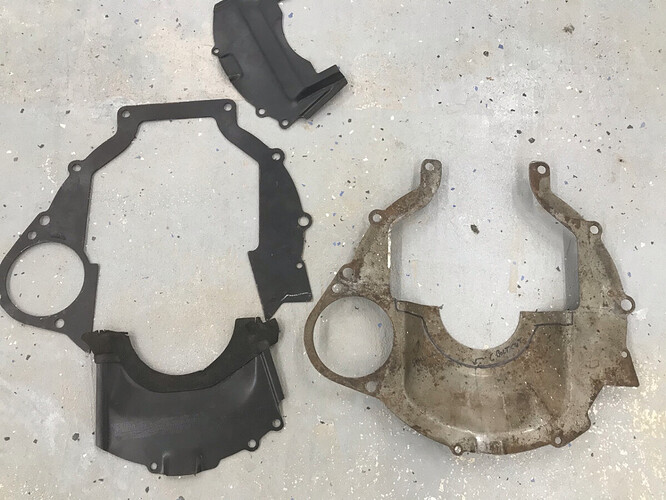

Correct, the block plate you show is for a rope seal. Attached pics are what you need for a lip seal engine.

You can modify yours something like the marked line in the pict. below, but will not fully seal it up.
Correct, the lower one. The upper one is needed for spacing of the dowels etc.
I decided to use the lower one in the race car as it frankly stops a lot of muck going in.

Essential for starter motor location and support. Get the correct 6 bolt crank 2 part version, there are 2 or 3 bolt starter fixing type.
