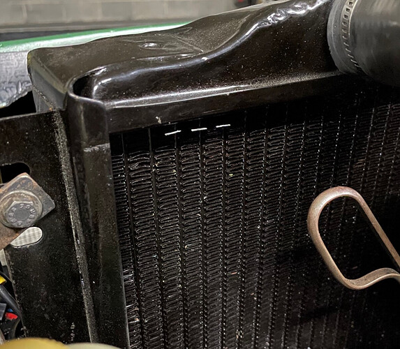

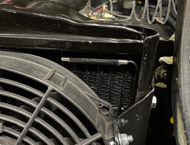

Last year I had my standard radiator recored and the company that did it begged me to not insert a temperature probe into the fins, which is what I had been doing before. The inserted probe had always worked fine but I never liked the idea much anyway.
My solution was to make a holder for the probe that allows it to lie flat against the radiator. The holder is P shaped as shown in the sad little drawing below. The probe is a tight fit in O of the P and the leg of the P has slots in it which are spaced to fit between the water channels in the radiator. Obviously, the flat areas of the leg sit between the fins. It’s made of aluminium and painted black. Copper would probably be better but I didn’t have anything on hand so decided to mock the idea up with some spare ally that I had. The mock up became permanent.
The teeth are long enough so that they fit through the full thickness of the radiator and can be lightly bent on the other side to ensure that the holder doesn’t vibrate out.
Everything fits very snugly and it works perfectly.
Nick
I suppose a little insulation could make it track the heat of the radiator better. John

Yes, that was the second step of my plan but it hasn’t been necessary. Or making it in copper, or with more teeth, or mount it on the rear of the radiator.
I imagine the probe runs a few degrees cooler than when pushed directly through the radiator but the thermostat has an adjustment that allowed me to take this into account when setting it up. According to the dashboard temperature gauge it starts running at the same temperature as before - I set it to 90c.
There’s obviously no reason why it shouldn’t work just fine, which is why I made it in the first place, but I have to admit that I was surprised by how effective it is. Of course, the standard approach of pushing the probe through the radiator fins doesn’t exactly win any prizes for design elegance. :slight_smile:

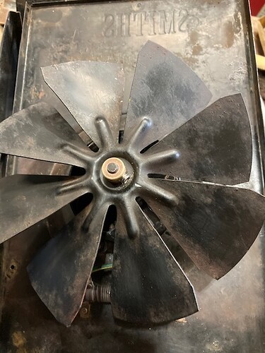

During our last long drive this pas fall, two issues came up: 1) the driver’s wiper blade “slipped” - it would sometimes park way high, sometimes way low; and 2) the squealing of the heater blower motor, always an issue, became a show stopper. Plus, the passenger heat was significantly less than the driver’s, for unknown reasons.
So the current project is to go after both those issues. To date, the dash is out. I’ve taken the heater box and motor apart, cleaned and lubed the motor, and reassembled. Motor spins easily, and quietly now. Unfortunately, I also striped the grub screw threads on the fan, so I’ll try rethreading up one size.
Many thanks to JonB - his post of a couple of years ago clarified how the motor should go back together.
Still to do - get the wiper mechanism out, and figure out what’s wrong. I thought maybe the gear box had come unbolted, but nope, that’s not it. Maybe something wrong with the cable? Or broken teeth on the gears? Will know more tomorrow.
Pretty amazing how much junk gets sucked into the box over 49 years or so…

It turns out the fan grub screw is a #10, so I got a 1/4” one, drill and tap, and upgraded. Motor works great now. I’ll take the time to paint the box while it’s out, and I’m waiting for parts.

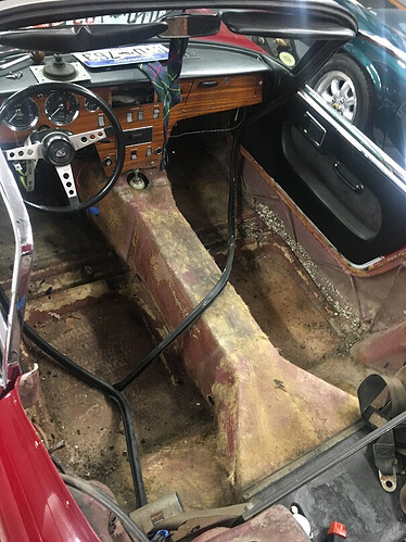

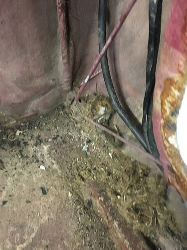

Today I believe I’ve found the last of the mice who gave their lives in the confines of my car- I think that comes up to 12 or so in total, after this car sat for several years. This may take care of some of the old, musty “vintage” car smell…
The good news is the lattice frame inside the sills is in fantastic condition, so after a good cleaning, I can get back to installing the new carpeting. Just need to figure out how to cleverly locate the screws in the side panel boards as they go back on.

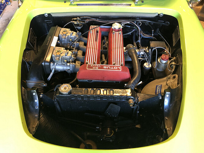

Just finished up my Cylinder Head change & engine bay tidy up from over the winter :smiley: :smiley: :smiley:
Time to take her out for an Italian Tune-Up!
Tidy, indeed Phil. Looks great.
