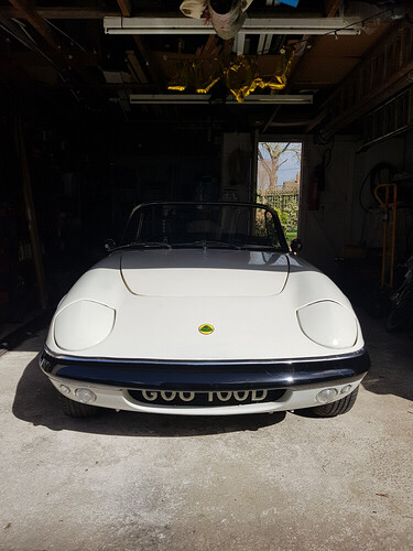

First wash of the year to get the mud off! Second wash in the Autumn!!
You’ve only gone and washed all the orange off yer indicators, David …

You’ve only gone and washed all the orange off yer indicators, David … says Tim
So much more elegant Dear Boy - so much more elegant!!

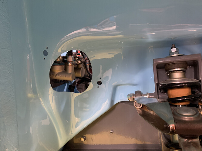

Finished making a cover for the M/C and moving the pedal box over a tad to avoid as much wheel rubbing as I can.

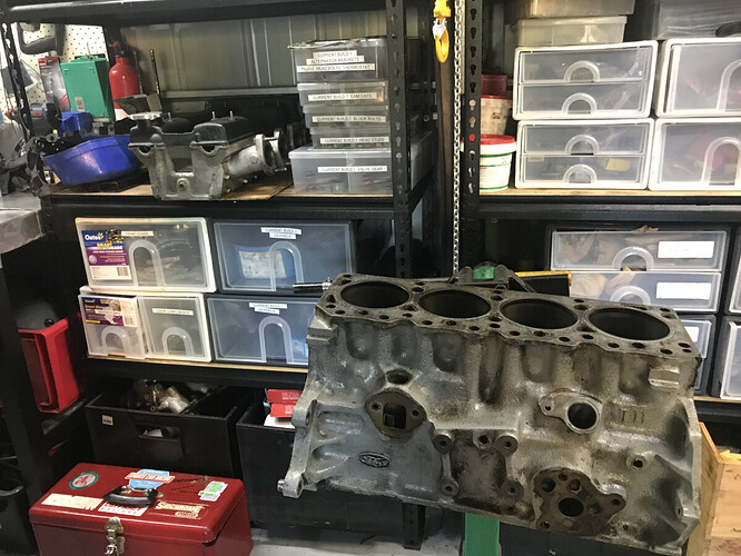

Stripped my spare race engine down to component parts for a full rebuild to my current premium unleaded specification as can no longer use Avgas and I need to machine a little of the tops of the pistons to drop its compression ratio
My son did it, having previously never pulled an engine apart in his life, with a little guidance from me in 4 hours. Could have been quicker but spent a bit of time showing him the differences between standard and race engine components as it came apart.
The clean, detailed inspection and measuring, chasing new parts and rebuild will take a little longer but nothing really needed on initial inspection except for a new set of crank and rod bearings
