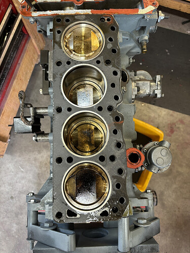

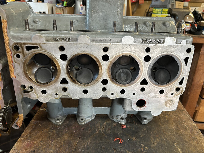

Today’s update. With the head off, I sent pics of the head and block to Barry (the head guy) and Ken (the parts guy). Barry id’d where he thinks the coolant leak is - the passage between cyl 1 & 2 has a bit of roughness there, so we’ll skim the head to remove it. He also asked that the head be pressure tested, so that will happen too.
Maybe the bigger issue is the oil on top of the pistons and seeping in front of #1 and behind #4. And the fact that the cylinder walls are mirror smooth after about 100 miles. Barry thinks the hone wasn’t appropriate for the rings, so I’m working with Ken and the machine shop on that. Ken’s a bit mystified, because he’s sold a lot of these rings without seeing this issue, so I asked him to call Barry to discuss. As for the hone, the machinist who worked the block has retired, and isn’t returning calls from the shop. So while they they have confidence he did it to spec, they can’t prove it and it sounds like we’ll never know exactly what he did.
I’ll pull the #4 piston and take some pics and send those on, but it sounds likely that we’ll replace the rings and rehone, so the entire engine will be coming apart for that.

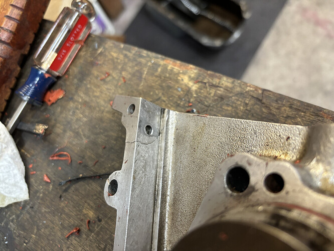

I was concerned about finding the crack in the front cover. Nothing to worry about there, as soon as I got the front cover and damper off, the crack was visible. I found a shop in town that thinks they can weld that up, so I’ll take it to them tomorrow.

IMO, the oil on the surface of the gasket, and the coolant leak, indicate insufficient clamping, which Ken agrees with. I’m using ATP head bolts. Ken had me check to make sure they weren’t bottoming out. So far I’ve checked one, which wa .2" short of bottoming out, so no problem there. I’m guessing the others are the same, but I’ll check them, too. When the head goes back on, he suggested spraying the gasket with Copper Note, and torquing to 70 ft-lbs as well.
