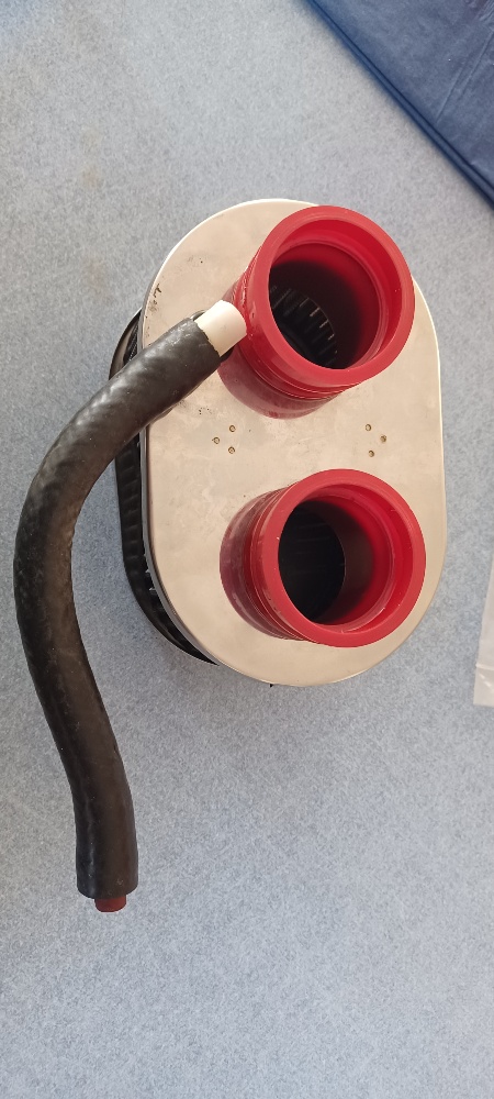

Apparently, he had one of the filters sucking dirty air from the engine as it appears one of the filters was connected directly to the cam cover (see pic). If so, it might be easy to repeat this.
I’m not sure what he was using to purge the crankcase. I suppose I could your suggestion and set up a catch can to accomplish this. Actually, I could use a single catch can for both.

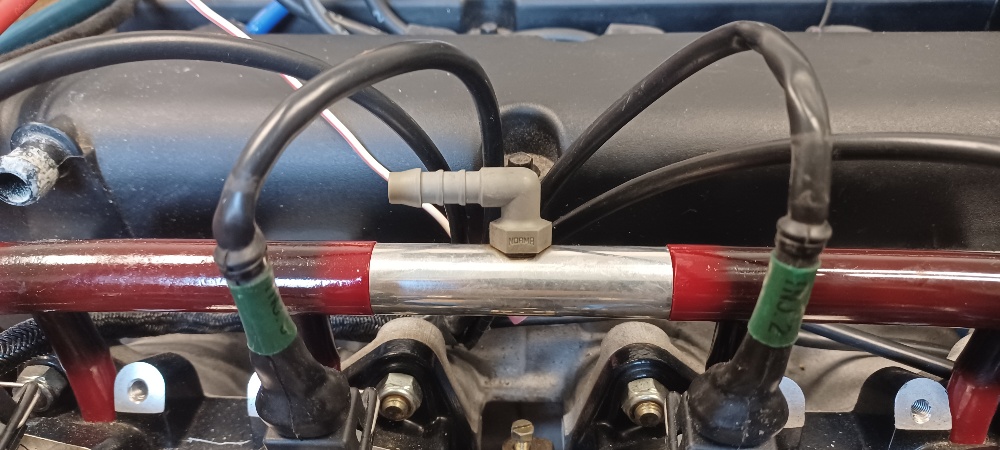

Regarding the ICV and MAP (pictured) please note the air intake joint on the balance tubes. Do you think he used this source for the ICV and MAP?
