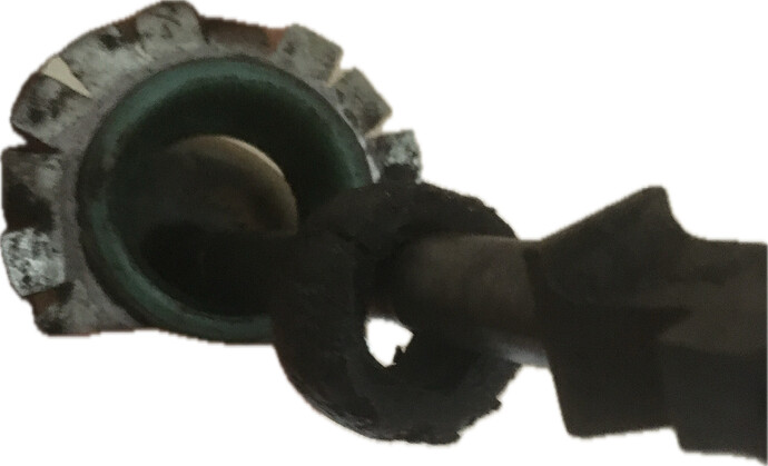

The 5 speed in my sister’s plus 2 had a terrible gear change. It’s never going to be as good as a 4 speed, but it turned out the culprit was the terrible Ford gear lever. It slides through a plastic bush to give reverse on a Ford box which isn’t required. It should be almost an interference fit. Hers had 1/4” clearance round the lever. And then it just came off in my hand one day. You can only remove and refit so many times before the tin lock plates fatigue off.
I don’t think oems are still available and speaking to people who’d worked in Ford dealer parts departments they didn’t have fond memories.

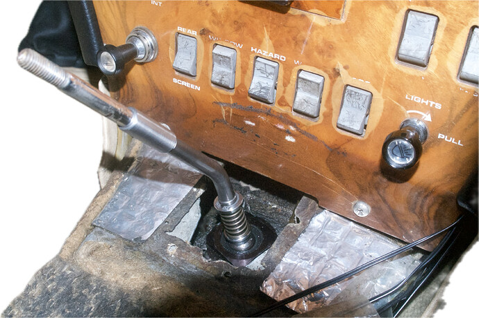

Not cheap but I got a curved Quaife rose-jointed lever, and had the original one cut & joined to it via a sleeve to give the same height. I also dumped the plastic Cortina? gaiter. It was so stiff it had broken up the casing over the transmission tunnel. Leather one looks so much better.
2 benefits, the Quaife curve moves the knob back into a better position with more clearance between knuckle and dash; &
a much more precise change with a clearly defined gate. I’d never realised that the sideways movenent across from 1 to 3 measured differently to 3 to 5.
I’d say it was perfectly acceptable now.

There are more choices now than when I bought and I can’t find it on the Burton site. But this link in the Quaife site shows the choices. Ford Sierra 5-Speed Gear Lever - Quaife Online Shop
I’m pretty sure I didn’t get the Caterham version and the longer one needed extending to get the knob the same height but farther back than the original.
I’ve tried to upload a pic of the base of an original lever, I doubt yours is as bad, and one showing the Quaife fitted with sleeve.

I’d mail Quaife with a pic of the base of your existing lever, and explain you want a curved lever which will need to be extended post purchase.
