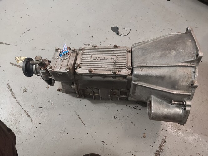

I have one advertised in the forum market place.
I previously posted one over to the States about 10 years ago, a courier was organised by the buyer to come from London Heathrow area, collect it, palletize it and despatch, doing all the transfer documentation for customs.
This one could be done the same, I’ll give full support for the job to be completed.
It’s gearbox, Speedo drive and gear lever only, without bell housing.
Picture attached ( bell housing to be removed before sale.
The gearbox has been professionally rebuilt with any new parts, shafts, gears, bearings, seals and gaskets.
It’s in A1 condition.
Price is £1500 Ono.
