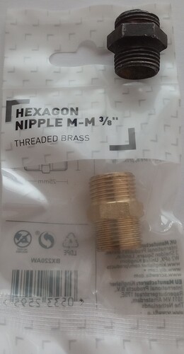

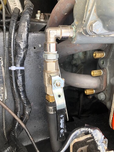

Thread size advice: thermostat housing heater valve port
Original 3/8" BSPT with brass equivalent: £1.96 at Screwfix
Got fed up with the inconsistent quality of the heater valve. I fitted this yes I have to pop the bonnet but at least this works and is definitely 3/8 gas thread to the head.
