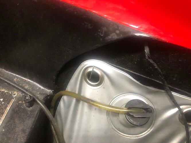

Hi tIm
Thanks for your reply.This is what I have in the engine comp one either side of the engine they are not holes but ducts around 4 inch long facing forward ,but they are blocked off.No idea why.Is it a good idea to open them up to the wheel arch.they are obviously there for a reason.Does anyone else have these on there sprints.This one is a 73 l reg

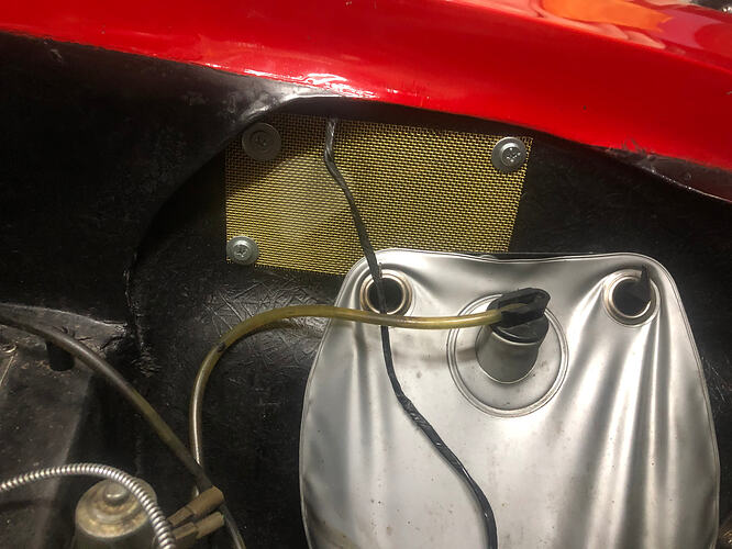

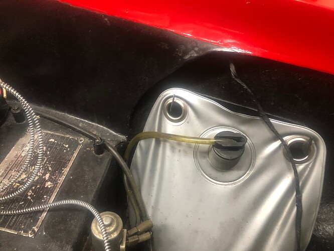

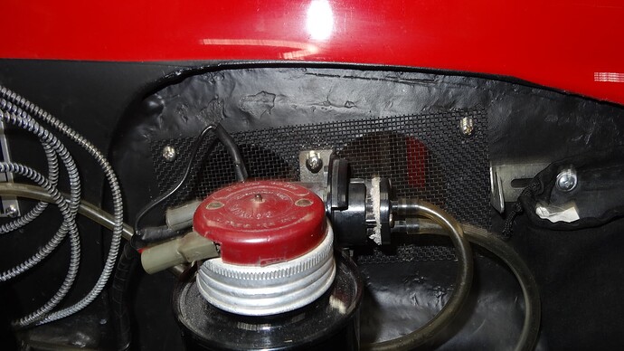

Your washer bag is in the wrong position. Here are the holes on my ‘72 Sprint

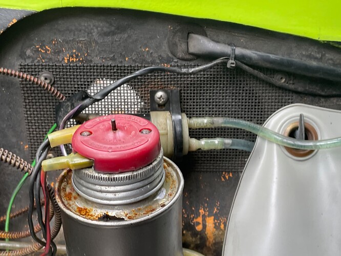

From the w/s manual.
Brian.
They are not ducts. They are just the relative shapes of the top mould laying above the bottom mould of the bodywork shell. Why they were made that shape, is probably lost in midst of time.
The 2x circular holes described elsewhere are the keys to venting hot air.
And IMO to still not effective enough. Bonnet vents, especially above the carbs to prevent fuel evaporation, would be much more effective.

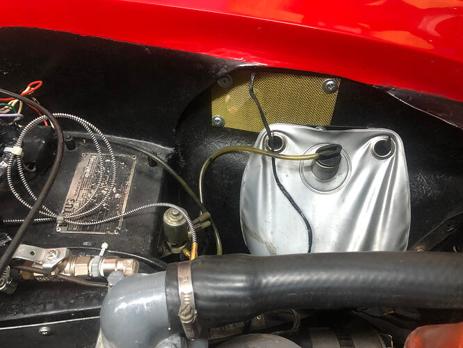

My holes, in a similar position to Greg’s (& the washer bag.) Maybe the holes have a larger diameter?

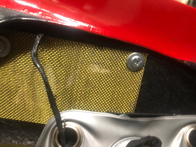

I did the modification of drilling two holes and some gauze for extra cooling in inner wing and took her out. The temp was around 85c and I did give her some stick.So at moment there’s no problem with getting too hot.The proof of the pudding will be next summer when temps outside rise.
if anything as I said previous it carnt make things worse.I will post again on the outcome.

The holes in that screen seem a bit small. You can find screen that is rated by the % of open area, and you want something that is 60% or preferably better. 1/4” opening screens (~75% open area) would be adequate to keep the boulders out, while letting air easily pass.

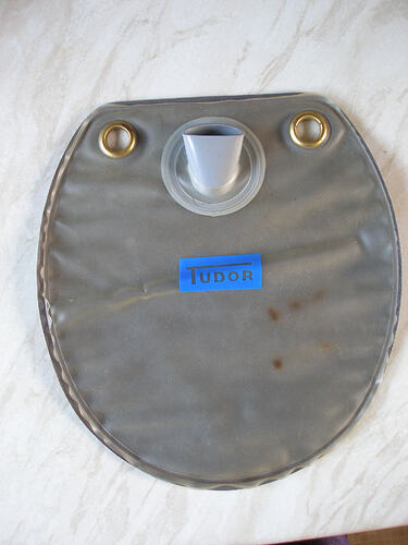

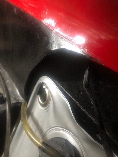

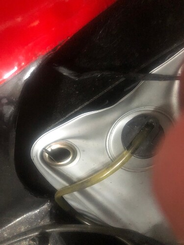

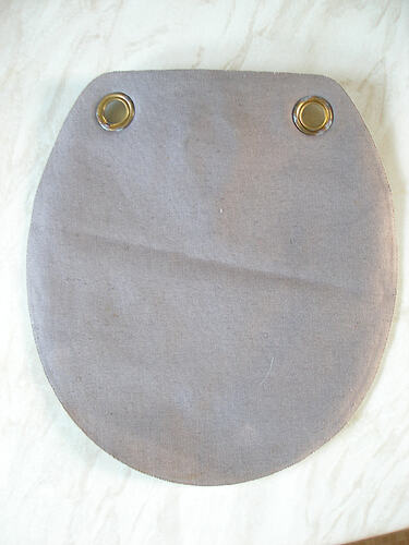

Mucca, or should that be Maga, when we chatted at Castle Combe earlier this year, you mentioned that your car was brick slow. Now that you have shown a picture of the engine bay, it is clear why. Your car will accelerate twice as fast if you have the correct washer bag fitted. Get in touch if you want to be a true ‘boy racer’. Make sure you are sitting down when I tell you the price. And you may want to change out of that white jump suit. We wouldn’t want any stains showing through.
Leslie
Of course it comes with the correct Tudor top, need you ask.
512
its Macca by the way and the old bag has been with me for 45 years.It would be very costly to get rid of her now so I will stick with her for the time being.Thanks for the offer though.
BTW jump suite a little tight now middle age spread .You know what I mean.
