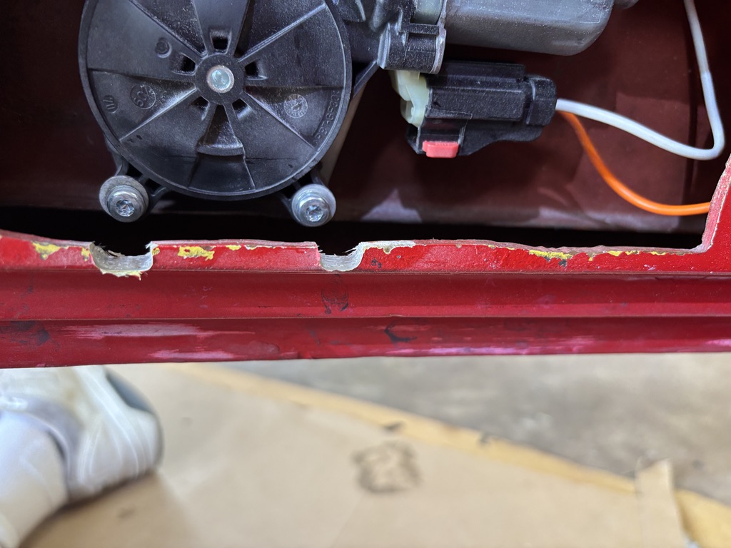

I’ve made this upgrade and highly recommend it. As the Brits would say, it’s brilliant.
A couple of notes:
  1. Mike has added 10-32 fasteners to the kit, so you don’t have to source them. Lockwashers, too. They’ve got T–25 Torx heads. I put plain washers under those to protect the plastic mounting lugs of the motor. You’ll still need to provide the 1/4-28 x 1/2” bolts on your own.
  2. To get a driver on the bottom 2 of the 10-32 fasteners, I had to take a die grinder to the inner door skin. See pic. On the right door, I drilled an access hole as an access slot would have been so deep.
  3. I happened to have a crimping tool in my arsenal from my Mate-N-Lok wire harness conversion project. I got it off Ebay. I’ve found a similar one on Amazon that looks like it would work: iCrimp Weather Pack Sealed Connector Crimping Tool - Wire Crimper for Delphi Metri-Pack 150, 280 & Weather-Pack Terminals AWG24-14 - Amazon.com
  4. Oh, and if anybody out there thinks that maybe the frame can fit back in the door with the motor spacer and attachment plate already bolted on, it won’t. It’s probably pretty obvious to most people, and most won’t be doing this as part of a cable repair, so the frame won’t be out of the car anyway, but for some reason I just assumed it would work without looking very closely at how long those mounting studs are.

For anybody reading this thread and on the fence about getting Mike’s kit. Do it. Super easy to install, no rattles, lighter, smooth, fast, and invisible. As noted above, those two bottom 10-32 Torx fasteners are a bit of a pain to get to with a driver - I replaced them with hex heads to come in at them from the side - no problem.
