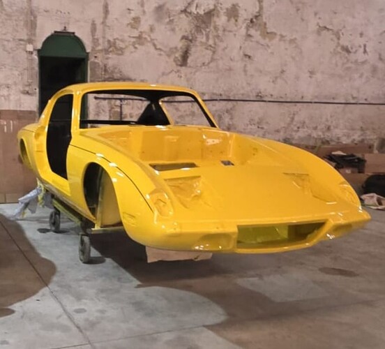

I’m currently restoring a Lotus Elan +2 S and documenting the full restoration process from start to finish.
The car is currently painted and completely stripped. I received it already dismantled, and while building a full parts list from the original Lotus manuals I realised that some important parts are missing.

On a more personal level, it looks like your car is the best colour! :grin:

And yes, I couldn’t agree more on the colour. Some choices are simply correct.
