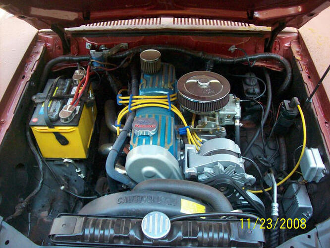

Terry,
Attached is the alternator and bracket that I have installed on my federal S4. I send this only to show how simple the bracket is, not that it would fit your alternator, but that one could be made very easily. I was never able to get the adjustable connector to fit at the top, and instead used a part similar to what you pictured from an old volvo.
Good Luck,
Dan
cost ?78.00 + carriage +Vat :open_mouth: :open_mouth: :open_mouth: :open_mouth: :open_mouth: :open_mouth: :open_mouth: :open_mouth: :open_mouth:
Dan
Looks like I will be getting one made like yours!
Terry
