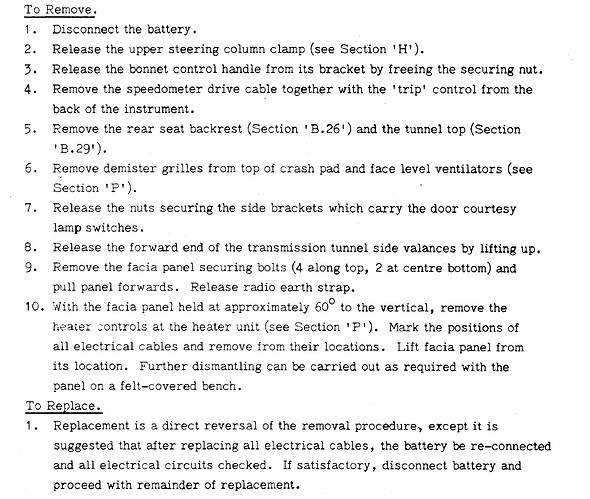

I have attached the Lotus manual info re removing the dashboard. I notice it says 6 screws for the dash I think U have got to get out the 2 covered by the transmission tunnel top

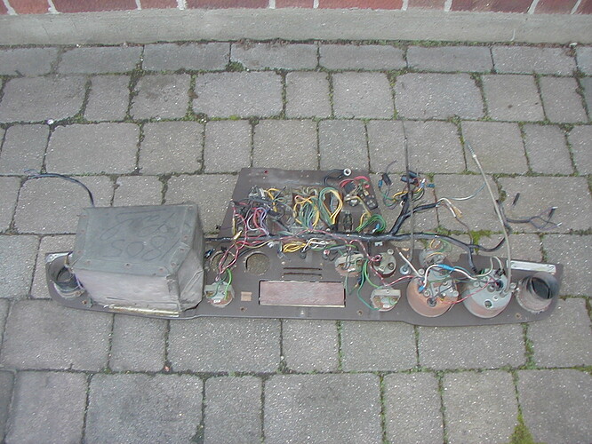

have also attatched a picture of my dash upside down bottom at the top and you can see the two remaining bolts U have got 2 get out.
