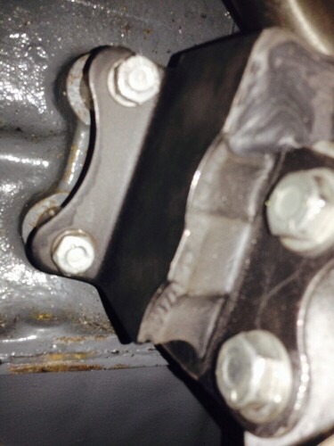

Well, I fitted the new, heavy duty engine mount as advised, and guess what ?- immediate SUCCESS!

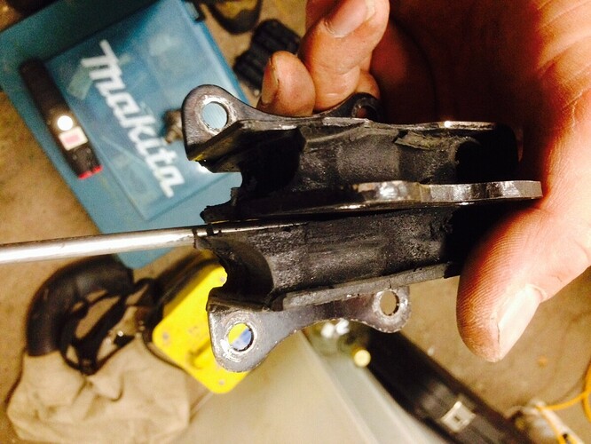

When I removed the existing LHS mount it all but fell apart in my hands ! (see picture attached)
I just can’t believe that this mount has failed!
The engine has not been run since the mount was installed, the engine has just been suspended on the mount and it’s been sitting in my garage with no stress on it, for 5 years - and failed !!!
Conclusion: This must have been one from the batch (at that time) that there were problems with ?
Just as a matter of interest, it appears that the rubber was vulcanised (if that’s the correct terminology?) to painted steel parts of the bracket - as I can detect black paint on the metal where the rubber has become un-attached ?
I wouldn’t have thought it was a good idea to bond the rubber to a painted surface ?
Least ways the new mount installation has pretty well cured all the issues in one hit -
Namely:-

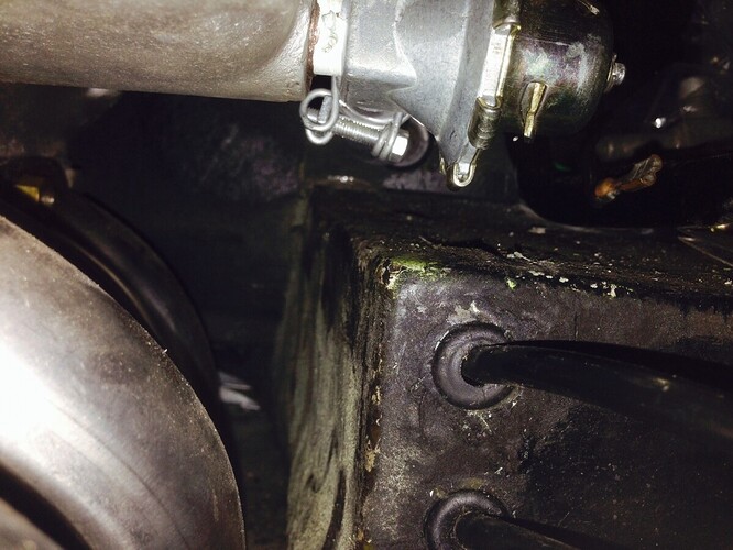

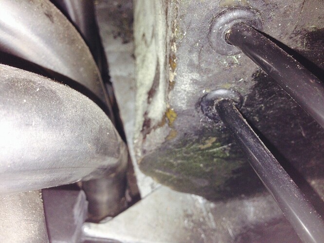

More clearance under the heater valve (25mm now)
More clearance between the fibreglass footwell and the exhaust down pipes 1/4" ?
Obviously more rigid support of the engine( Rohan I really appreciate your advice but I read it too late! - so must admit I did forget to change the Heater valve whilst in progress - dummy me !!!)

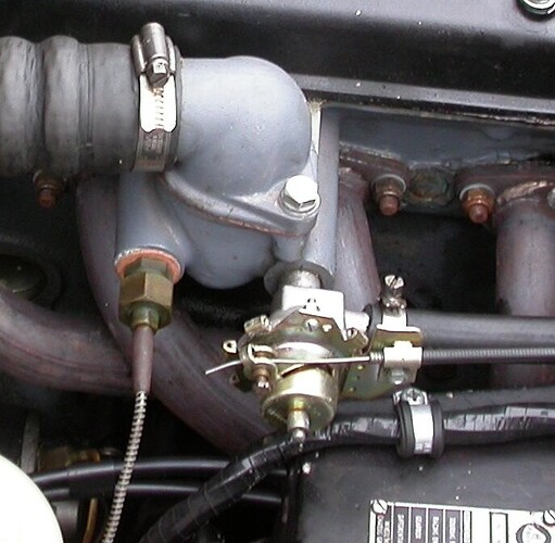

If you don’t want to undo the L/H engine mount to raise the engine to change the heater valve, there is another method you can use to achieve the correct orientation of the valve. To do this, the section of the valve that carries the diaphragm and the operating mechanism are removed from both valves and the parts swapped over.
If you refer to my photos above, you can see a pop rivet at the top of the valve. This rivet needs to be drilled out of both valves to allow disassembly. Twist the operating half of the valve (cw or ccw shouldn’t matter) whilst holding the back of the valve, about 5 or 10 degrees, and carefully withdraw the innards. Swap over, replace rivet and all should be okay.
Cheers.
Colin.

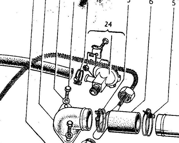

This may be of interest.
The configuration of the heater control valve within the S1 workshop manual is different to that posted by Colin above.
The control cable is connected to the top of the valve - giving more clearance beneath the valve.
I have this type of valve (purchased from a Land Rover parts supplier) fitted to my car:
It now seems that the vast majority of valves which are for sale are of the type shown in Colin’s post rather than that shown in the S1 manual.
However I did find this one:
famousfour.co.uk/new_parts/p … rtID=15121
