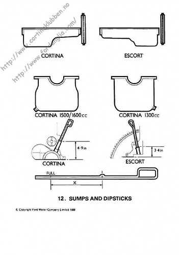

1300 sump??? …Big end cap catching…which side is the oil drain plug on? Right side on a 1500 and Left side on a 1300 as I recall.

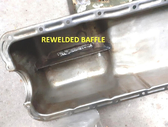

Is the oil baffle plate secure and not catching the crank? I’ve had those baffle plates come lose before.
Once I had cleaned the oil from inside the sump I noticed the baffle plate although firmly welded had a shiney edge to it with a very small sharpish piece on top, I will file it smooth and see if there is any difference.

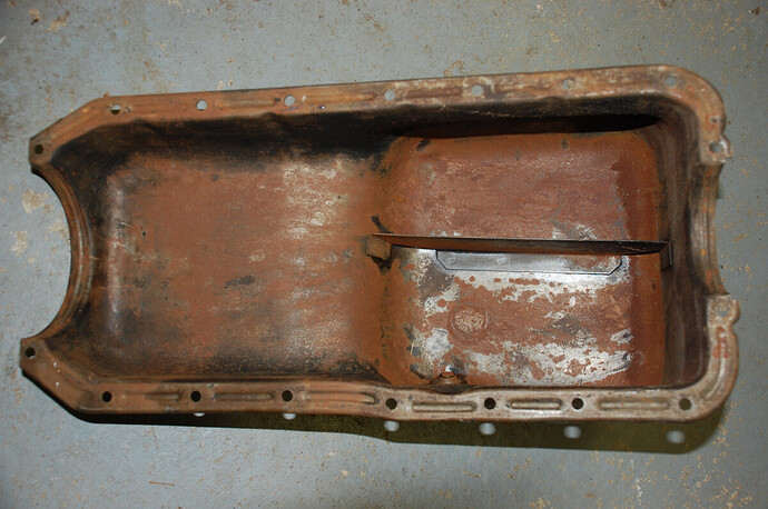

The baffle in my picture is original and correct for a 6 bolt crank, the 4 bolt crank has a different baffle.

Where was the damage to the baffle, right at the front beneath the timing chain?
My baffle is the same as Brian’s, it had a shiney edge approx. in the middle with a small sharp bit sticking up, I nearly nicked my finger on it so filed it smooth,

Something strange is going on here. The clearance of the centre baffle to the crank is substantial. The top is slightly below the raised rear section of the sump where it joins it so no way a small sharp bit on the baffle should hit the crank rods. Something appears to be non standard.
here is a photo of the standard 6 bolt sump and centre baffle
