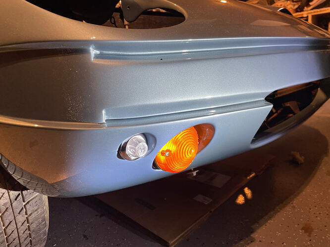

Just was getting reacquainted with the project this week. It was kind of a Triage week. Only general items completed this week, with the installation of rear, parking and indicator lights.

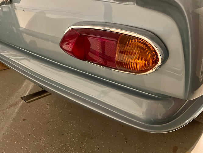

I have 5 sets of rear taillights. I cobbled together the best of the lenses, and frames for the assemblies with new seals. Polished the lenses with Plastic-X and chrome frames with Turtlewax chrome polish. Now I have 3 assemblies Left. Interestingly, they are all marked “Left”-coincidence..?
