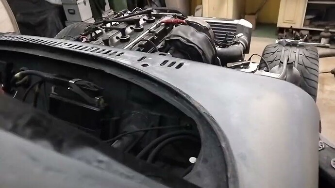

Following the initial startup using a remote switch, I had my wiring/ECU guru come over and sort out a few issues and wire up various bits including the start button. The engine sounds a lot better than on the video :slight_smile: We restricted throttle response to 20% until my tuning guru sets it up properly as it is only fitted with a basic MAP.

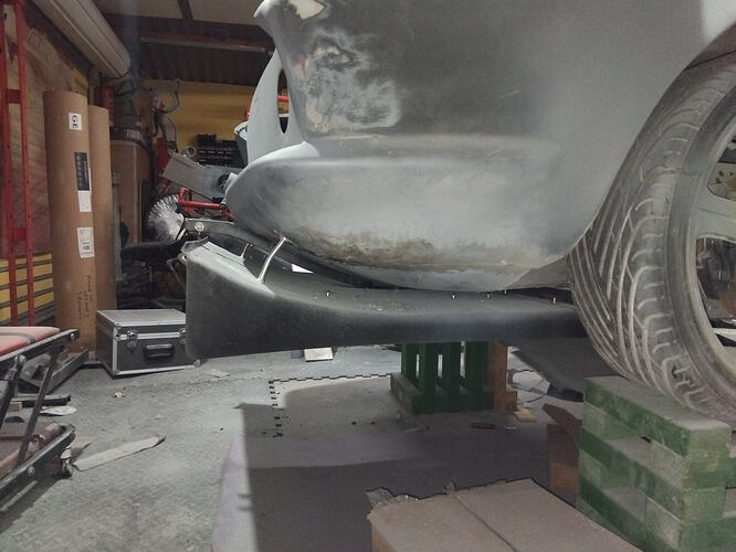

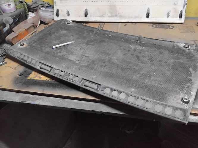

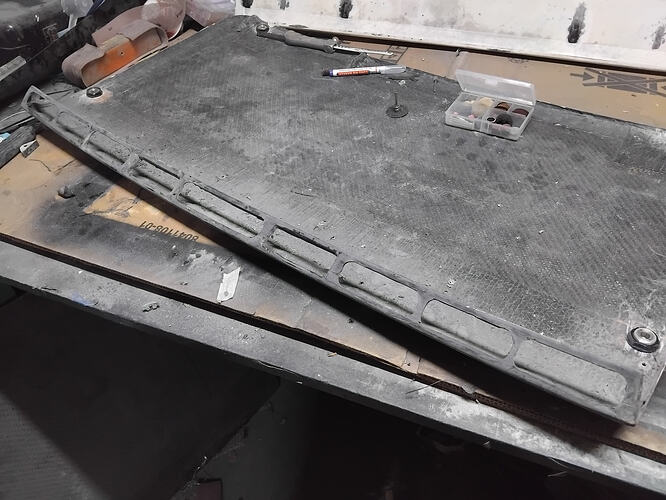

Whilst tidying up the countersinks in the rear wing support brackets I kept looking at the holes in the boot lid. As they were similar to the ones I extended in the rear panel I thought that it would be wrong not to do the same with these. 30grams later job complete.

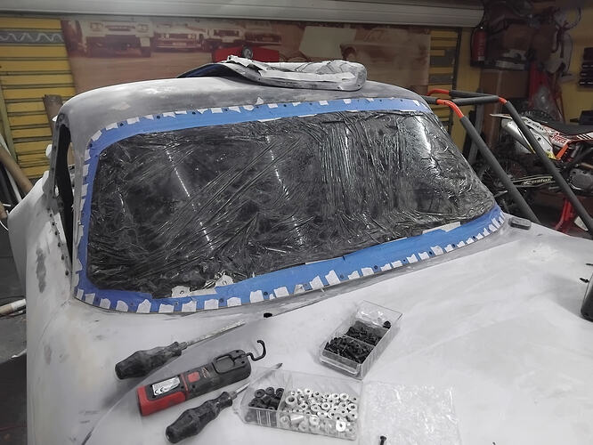

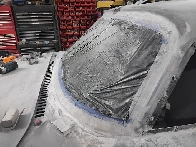

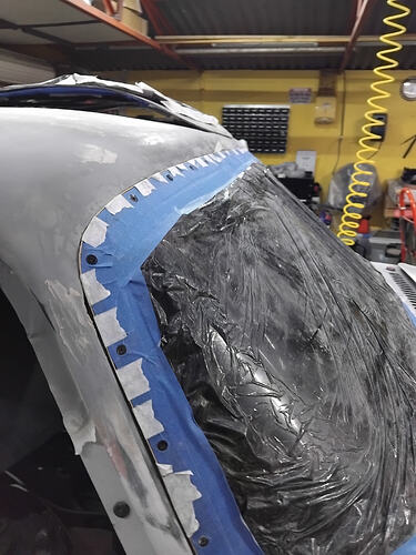

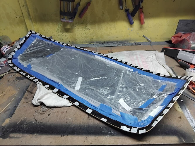

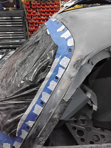

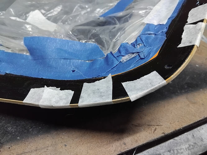

Got to grips with the windscreen fitting yesterday. I had added a cardboad spacer around the perimeter held on with sellotape but this was starting to unglue so I ripped it off and started again. Used tiny drops of glue and masking tape and buffed it with mould releasing wax.
Although it has been on and off many times before I reckon that the cold temps had shrunk the poly slightly so a lot of the screws argued about being fitted but, eventually, they all saw my point of view. I hadn’t persuaded all of them when I took the photos.
The fit is better than I thought it would be, so very little filler will be required. The fit looks worse than it is due to to the cardboad lifting in places, but this isn’t an issue as it will be pushed back into place by the P40. I have seen many screens fitted that have a worse fit but I can’t leave it the way it is. No wonder this project is taking so effing long!

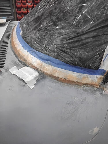

Forgot to put the garage heaters on this morning so didn’t get out there until later on in the day. Started on shaping the windscreen surround to match the poly. However, it was still rather chilly so the P40, even with double the recommended hardener in it, was reluctant to cure so I only got the first layer on. I will carry on with it tomorrow. I know, the weight :slight_smile:

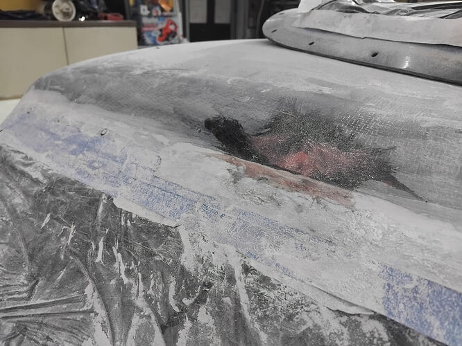

One of the downsides of making stuff light is that it is easy to sand your way to the other side. The roof is 2 layers thick so I managed to make a small hole whilst sanding the filler to shape. However, easily fixed with P40. Not the first time and probably not the last :slight_smile:
The moment of truth, will the screen release?
