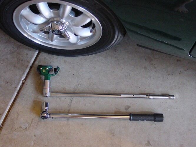

A breaker bar with a 1/2 inch drive, fits all my tool’s hex shaft with the socket I supply. If you use a breaker bar only, make sure you have a feel for the suggested torque setting. I have seen breaker bars that have a ratcheted head for more money. I still maintain, if you are pushing down on the breaker bar, you can control the force you are applying rather than pulling or pushing on the bar at odd angles. A torque wrench you just wait to hear the click.
Pictured is my breaker bar and Torque Wrench.
