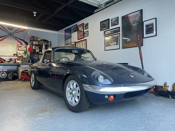

I took the “bumpers” off and removed the wrap so I can wrap them in “chrome” vinyl so I can merge the quotes and officially have “chrome bumpers”

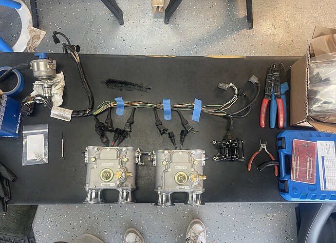

Whew! Time flies, cant believe its been almost a month since the last update and sadly not too much to update. The conversion is moving along slowly. I had a few time consuming events in the last month so hoping to get some progress, but heres a small picture update of where its at.

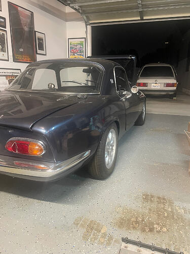

Heres a few pics of the after-product of the “chrome bumpers”
Overall, Im happy with the look. Its not perfect but it accomplishes the job I wanted to get done with the chrome wrap. Now I can focus my time and attention on making progress with the ITBs/EFI conversion

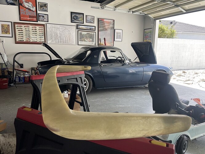

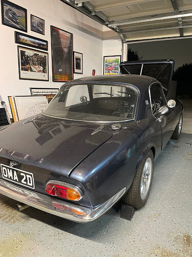

Alright, motivation is growing and I finally committed to getting it done. Cars up on jackstands and things are happening…

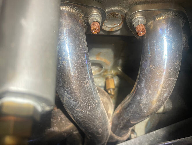

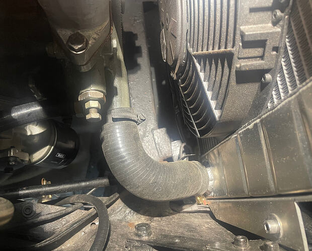

Draining the radiator and coolant was ‘fun’ because both outlets were going to cause a mess. Ultimately I went with the mess from the radiator than trying to control the mess that would’ve came out from the block drain.
I think I want to still drain whatever is left in the block because this coolant was pretty nasty. Any tips on preventing it from spraying on the headers? Its a tight space

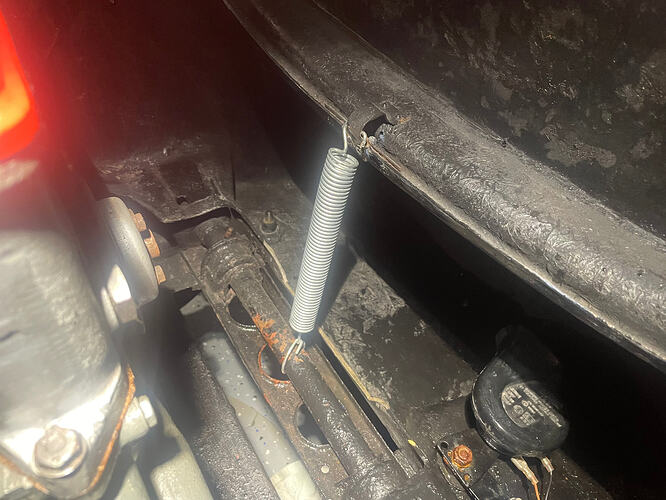

Heres the spring the builder used for the hood. Look like crazy overkill and is a nightmare at this point to try and remove by myself. I will get it off and I think I would love the ‘correct’ part
So now, just for fun I threw on the ITBs to give me motivation to get it done. They are just sitting on there because will need to come off several more times before I actually need to bolt it on.
Simon, that spring looks correct. It’s a fairly unique part. What makes you think it is
incorrect?
Im totally clueless, so it could absolutely be correct!
I recall seeing it relatively easy to remove the spring so that I can remove the hood, but maybe I saw that wrong. Its quite stiff, so maybe mine being a ‘new’ one and most being ‘old’ is the difference.
It can be difficult. I made a small hook thingie from a paint can opener. Helps
a lot. It also helps to have the hood / bonnet as vertical as possible to keep the spring as loose as possible.
「いいね!」 2
Have a look at Bonnet spring - #7 by Graham_B
It gives details of my cheap and simple solution. After a couple of times it gets much easier.

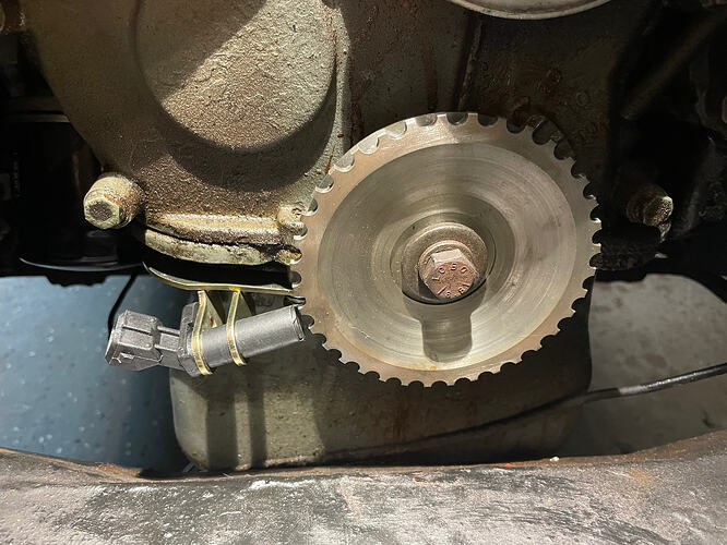

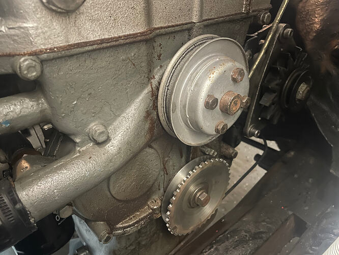

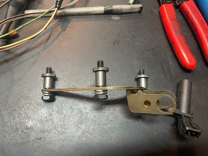

Spent my Friday & Saturday nights post-kiddos bedtime to try and make some progress. Seeing as how you guys suggested in the other thread that I can address the tooth that needs to be shaved off later, I decided the goal was crank pulley & Crank Sensor Mount. I ended up needing to put the rear back down to get the front up, my low rise jack wouldnt get under the nose when it was pointed down…
Just to add some perspective on this, I was quite nervous how the crankshaft pulley would be to R&R, and felt that the mount would be simple. This proved to be reserve of reality. The QED Toothed Crankshaft pulley went in quite easily, whereas the Sensor Mount proved I needed both more hands, and smaller ones. A pair of pics from the end of Friday night.
Trying to think of how I could hold all of the above together while I try to get it all back inside the tight space with no additional hands forced me to think creatively. The solution (for me) was magnets!… Took a few tries, but I was able to get it installed and basically cross this off the list and shift back to that harness.
…still no reply from QED about selling me just the harness & ECU, so I trudge on with the Focus harness…
