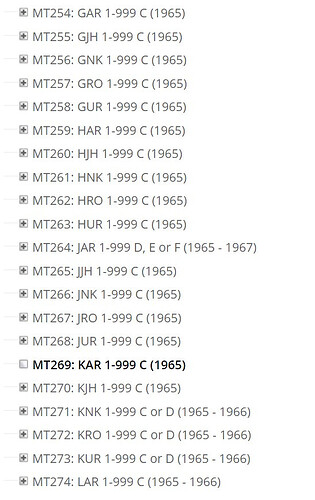

You were correct, no KARs ending in B. It seems the Chelmsford (Hertfordshire) office issued all of the KAR1-999 series in 1965, so they all had the C suffix (such as the now famous 120C). This, of course, makes the most sense given the lotus records on the car.
Hertfordshire County has an online archive with some basic information, including a hierarchy tree of records of registrations issued between 1903 and 1977. The following screenshot includes part of the listing.

I noticed that on a map but it seems Chelmsford issued registrations for Hertfordshire during that period, pre-DVLA.
Sorry to be a bit pedantic, but I find it difficult to accept that. Chelmsford is 50 miles from Hemel Hempstead where the Registration Office for the whole of Hertfordshire was located. AR is definitely an Herts registration. I did live in the area for a while. Happy to be proved wrong though :smiley:
Just checked a site online and note that AR registrations were exclusively Herts up until 1974. From 1974 onwards Chelmsford were also allowed to use the numbers. Seems we were both right ??? But too late for registration in 1965 when KAR 120 C was issued
Please don’t apologize, you are teaching me and I appreciate it! I was misinterpreting the records not knowing the area, but now see the correct interpretation is that AR = Hertfordshire pre-1974 and Chelmsford 1974-on.

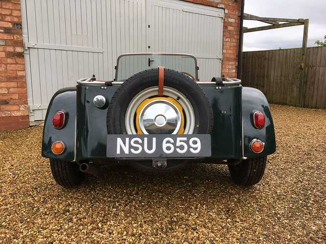

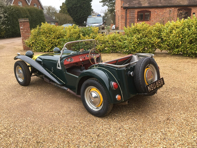

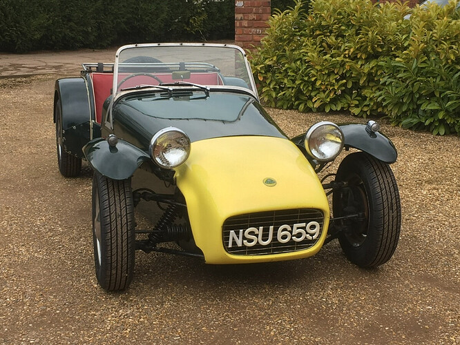

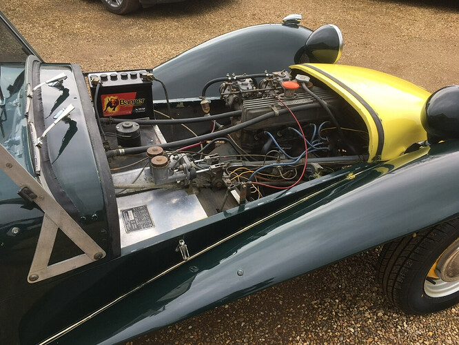

I was a part owner and sympathetic restorer of a 1962 Lotus Super 7 which we sold a couple of years ago, pictures attached below. This was also very original and had never been restored. It was great fun to drive and must have been incredible in its day. Apparently they were banned from racing in the UK as all other makes would have been uncompetitive.
I have lots of photo’s if you need information to get it period correct.
Dave
Great looking example, Dave!

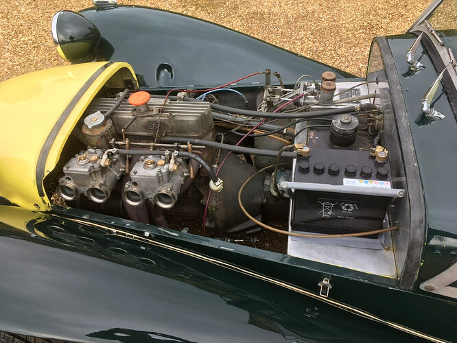

I have no schemes on returning it to concourse, but will lean towards period on bits I restore or replace so definitely covet pictures. In fact, the photo you pasted helps me with battery placement. I have a period style/size mount but was looking for pictures to confirm orientation for when I replace the more recent battery and mount that were on the car.

I see the exhaust was extended to the rear and fuel filler as well. Did you do these mods? I’m particularly interested in the exhaust extension and what impact it had on noise for passenger and driver.
It came with the extended exhaust and we decided to keep it. It gave a lovely noise without being uncomfortable for driver or passenger and did not suck back exhaust fumes. Having had a similar car with a side exhaust the rear exhaust is more comfortable.
It also came with the rear filler which was a simple rubber bend to a rubber grommit mounted period filler cap. From a practical point it’s much better than having to remove the wooden boot floor, its contents and possibly the hood to fill with fuel. They also have a small fuel tank, 5 or 6 gallons I recall, and fuel consumption around 25 mpg, so refills are frequent. So not original but very useful.
Dave
